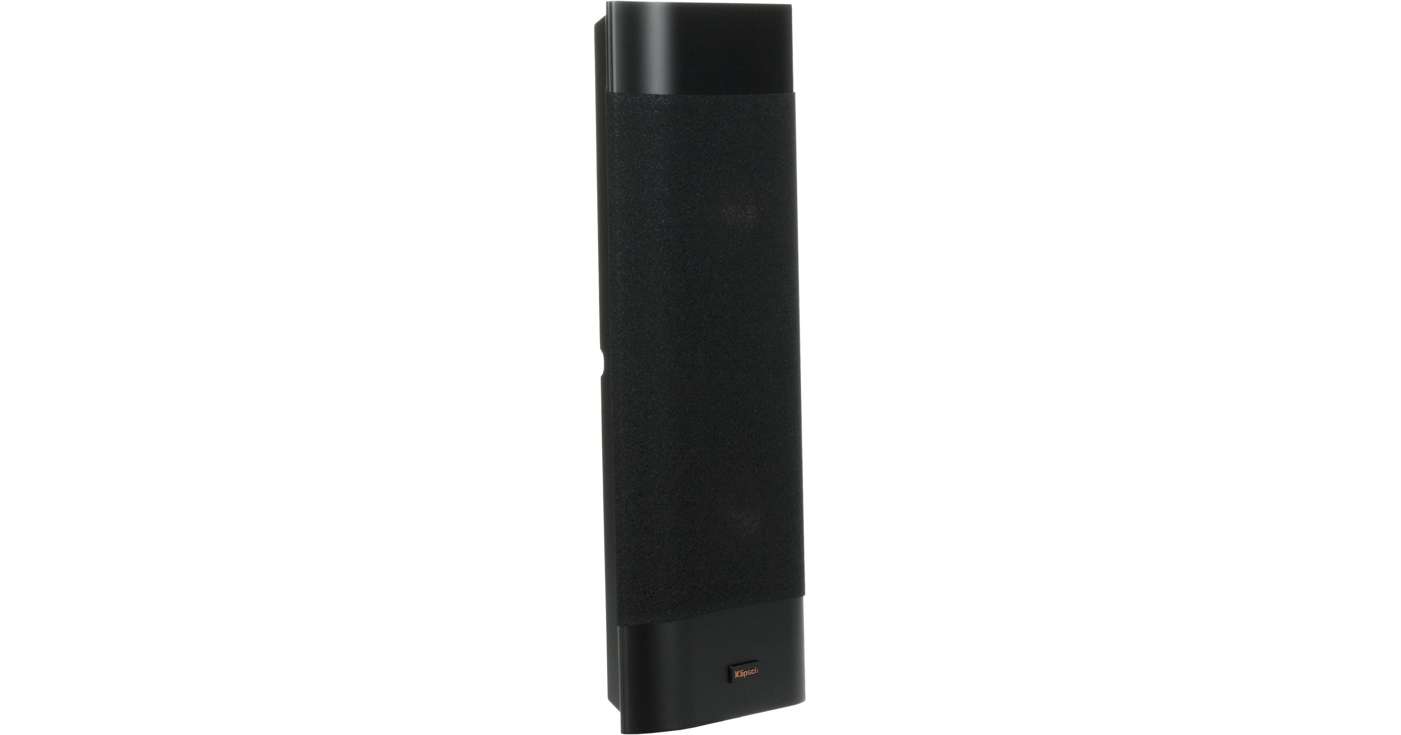

Mu suggestion is to go for wall mounted on-wall speakers / LCR ( left, centre, right) combined with two mini subwoofers plus acoustic transparent motorised screen will do wonders ..No obstruction for watching TV or PJ.... It will be aesthetically perfect for a living room ... 3L is Very good budget for PJ & Screen... Plenty of speakers out there for wall mounting ( not sony or samsung or Onkyo )... Just check Klipsch or Triad wall mounting speakers.
Not the above model, some models with very good drivers.."""" Just illustration i am giving above...
@srinisundar, will use my 2-channel stereo for now but I'll check to see if these can be mounted later. They are a bit big though 16"Hx6"W. Also, I'll prefer to use my speakers for LR and add center, rear and sub.
