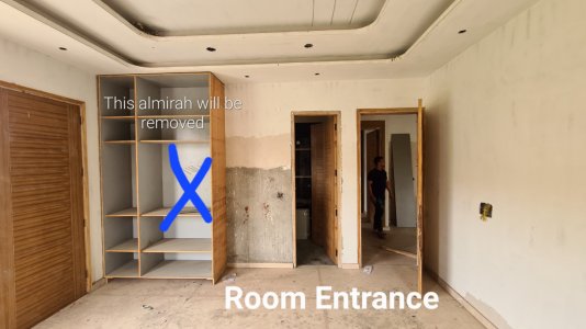

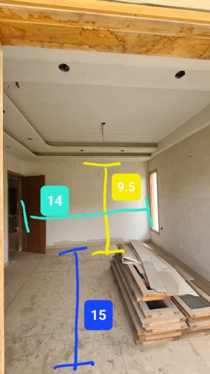

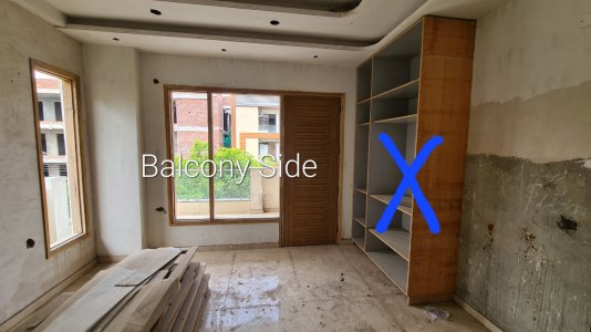

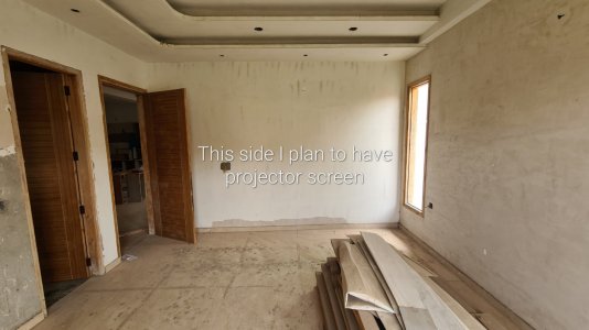

Room size is 14x15x9.5
Lowest point of flase ceiling is 9.5 feet high from the floor.
Almirah from the room will be removed.
Plan is to have room acoustics and minimal sound leaking out from the room.

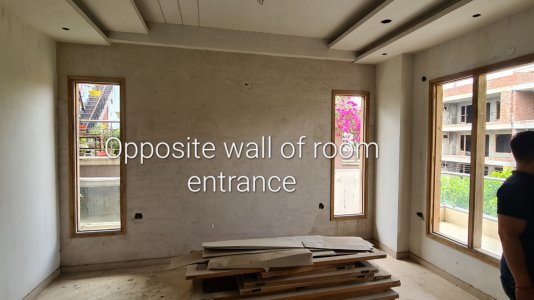

Simplest thing to do : use heavy curtains (black in color) on all sides. Use rock wool panel on ceiling. You can use multiple folded curtains/fabric (as design) also. Use your imaginations. Aim is to break straight acoustic reflections…….ie dispersion to make the room feel ‘dull’ to your likings. You can also use racks/bookshels (like at the back).
Arrange your sitting position taking sue note of room modes. And enjoy the joinery of experiments.
And upgrade slowly by:
Using a measuring mic like UMIK 1 and tame your room.
You can also use acoustic panels from MMT acoustic et al.
Your main issues will be the glass windows -they are very rflective.

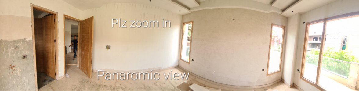

It doesn't look like you would need a whole lot acoustic treatment.
Since you mentioned acoustic treatment & soundproofing for HT so sound won't leak out, these are two different things IMO.
1 If you don't want sound to leak out then you would need a lot of absorption but it will be most suitable for movies case.
2 If you music to sound good then a little acoustic treatment would do.
3 For something that suits both use case scenarios, you would need something inbetween.
So try to achieve max with carpet & curtains as they cover more area and dampen good amounts already. For remaining part you can go with further using some acoustic panels as shared above.
One thing that'd be helpful for door sealant 👇 D shaped self adhesive. Very easy to put it yourself. Can use as a single by splitting or double as is. Very helpful.
