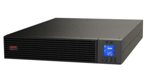

you have to plan for clean power supply as well.
Please add an online ups to the whole system and APC is very well known brand for this.
I recently got my PL200II subwoofer burned due to voltage fluctuation and BIC is not willing honour replacement even though its under 5 year warranty. I learned hard lesson. So pls make sure you have clean power to all this setup.
Also you can go for Microtech or Luminous Online UPS for better price compared to APC.
For voltage fluctuations, vertex servo stabilizer is enough, use ups only for power backup.
