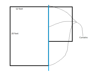

Hello HT Experts and Enthusiasts,
I want to build my first home theatre in a hall, that is L shape. Plan is to cut the L into rectangle using Acoustic curtains. Room dimentions.PNG

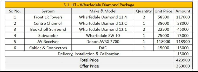

I had a demo of Wharfedale 12.4 package in Bangalore and I liked the sound signature. They gave me a quote as below for 5.1 setup. Subwoofer is 12". they forgot to change in image.
Is it really a good deal and HT setup?
Shall I go for Denon AVR X2800 instead?
Is there any better option with in 3.5 lakh budget?
Sorry If I gave you less information here but I want to get the opinion of members here. Kindly give your suggestions.
Welcome to the forum and happy auditioning!!
I have a Wharfdale setup as well and have the 12.1 + 12.C + WH-DFS + WCM-65. I like the warm laidback sound of Wharfdales. Check.out more on my setup in my profile.
What is your intended alit for movies and music?
With a subwoofer in the mix, towers do not make that much sense, as the bass will be handled by the subwoofer. You can consider getting bookshelves instead 12.2.
I am not sure of the quality of Wharfdale subwoofers, and would suggest to look at other options from SVS, REL, Rythmic etc. Subwoofer doesn't need to match with the speakers. I got the REL HT/1003 MKII for my setup and very happy with it in my 17*10 + 5*10(L) room. My viewing is along the 10 feet.
If possible, add Atmos channels to the mix as well.
I think there is still scope for negotiation. I got my Wharfdale 12.1 from HifiMart for 32.5 and 12.C for 27.5 in May this year.
Do check.with them for the same.
Denon 2700 is the previous generation model and shouldn't be for much lower. Get quotes for speakers and AVR from multiple dealers, online and offline.
Agree that for a 5.1 setup, Floorstanders are not required. Go for bookshelver for Fronts and buy a better sub.
Also consider Q Acoustics speakers.

Thank you so much, Suku_Patel_22 for your time and information.
70% movies : 30% music, mostly streaming content from Netflix, prime, Disney and music from Apple music.
I am currently having Benq TH585 Full HD projector and Firestick 3rd gen full HD which supports Dolby Atmos, True HD..etc. I planing to buy 4k TV with HDMI 2.1/eARC port in next couple of months.
I calculated with discount on Wharfedale from HifiMart but it's more than 3.5 lakhs. The quote from dealer above has 74000 discount on final price. They may reduce 5-10K if I bargain.
I will consider other subs(SVS, REL, Rythmic etc) as you suggested.
Not sure why X2800 comes for lesser price compared to X2700 online. I need to research more on this. Tanmay Mehta on YouTube mentioned that Denon has both US and EU version. US version is better than EU version. Any other recommendations on AVR?

Could you also suggest me where can I find acoustic curtains for my room. I cannot install acoustic panels as I'm staying in rented house. My owner is a nice guy and he allowed me to install projector and screen. I do not want to cross the line by drilling further more for acoustic treatment :)
You can get sound absorbing curtains from Ikea.
