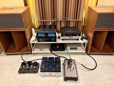

Been spending some time with the Klipsch La Scala, and it’s made me rethink a lot about setup needs in terms of room size, placement, and amplification. Speakers like these have a presence that’s hard to ignore: dynamic, immediate, and alive. But they’re also incredibly sensitive to the room and the gear behind them!
Curious how others have approached it:
  • Do La Scalas need a big room to work well?
  • What kind of amps have you found they pair best with.....tubes, low wattage, high damping?
  • How fussy are they about placement and toe-in in your experience?
  • And do you love that horn sound… or find it a bit overwhelming?
If you’ve lived with horns or even just heard them in a well-set-up system, I’d love to hear your thoughts.
These are big ones :)

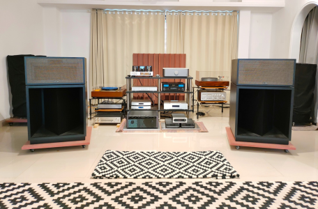

Sharing my observations of owning la scala's over last 6 months
I think they shine when given 15 feet separation (as recommended minimum distance) and listening at moderate to high SPL.
But i also listened in small 10x12 ish room in intimate near-field setup with low volume listening, still very good, but can not match my earlier Ls3/5a (falcon acoustic gold badge)
I tried tube el34, 300b, El84 SET amps, and monster 450W solid state amp (though all with <20-30 damping factor), from what i can hear they just need clean signal. Extremely revealing of the components, cables etc
Not so fussy, but very flexible IMO, you can place them in corners to boost low end. But i am not particular of imaging, sound stage, layering etc, good tone, timbre and live presentation is good enough for me.
Heard avantgarde mezzo, uno, and acapella's they are exceptional, but Klipsch heritage series is more accessible.
La scala Horn woofer is the biggest difficult thing for me to adjust initially, regular speakers low-end sounded bloated and not-truthful to me after listening to horn woofer. My only issue with la scala's is i wish it went down to 40's to be perfect.

Yes, the La Scalas scale beautifully and would sound their best in a large room. Obviously, not many of us can afford them a separation of 15' but to be fair, even 8' between them is good enough to provide a great soundstage with an overall cohesive sound. More tricky for me was the distance from the front wall, and I had to move these 90kg boxes back and forth quite a bit, which was so much more of a challenge after Prem's advice to place them directly on the floor.
Incidentally, removing the platforms from under the speakers and placing them on the floor made a huge difference, and so did adding a REL T9i that I had.
For amplification, I find that the lower one goes in amp power, the better the La Scalas sound. I am tempted to try them with the 1 wpc LTA mz2 or something similar. But what is impressive is that with almost every amplifier, they have that smooth yet natural presentation. And I really wonder what makes them sound so live. On more than one occasion, I've looked up from my laptop to check the source of a tap or a bell in the room, only to realise that it is part of a song playing on the speakers.
