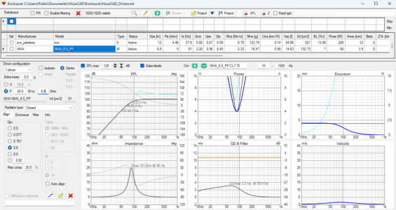

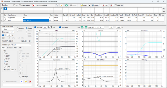

1) To get levels matched, there's one spot where you're going to need to pad 23dB...that's a whole lot and sort of defeats the purpose of the compression driver (unless it's purely to choose for horn usage). XO's for ewaves and the like are pretty easy to build-in the padding as part of the EQ/filter when one keeps attenuation say 10dB or thereabouts. FWIW.
2) 22L sealed with those starts a shallow roll really high and, that's fine if there are subs or some other LF support. If standalone, most of those types of boxes are designed with a hump at the bottom to make them more appealing / balanced. If you go 22L closed box standalone, it will be pretty "dry" (too much for my tastes).

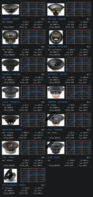

@biyer , you are looking for a horn which means to me that you want constant directivity. Econowave waveguides are easily available in pro audio market. The choice of your drivers is sub optimal. In home use, the compression driver will go quite low in frequency therefore should be matched to a bigger midbass. 10" is easily possible with that compression driver, probably 12" will work too.
