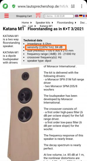

I saw on the net a two way OB kit from Monacor called Katana M1 https://www.monacor.com/products/components/speaker-technology/diy-/katana-m1
Individual speaker parameters are available from Monacor but not for this particular OB combo?
How to estimate the overall sensitivity? The kit is available from Amazon.de and perhaps some other EU based vendors. Before swiping the card have to make sure it won't sound anaemic with my SE amp that is 8W pc.
Thanks a lot. Wonder why Monacor did not publish these data.

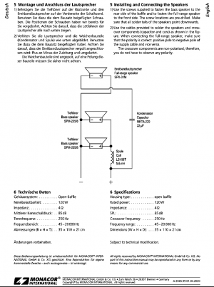

Monacor published 85 in the Katana instruction manual (and rated it 4 ohm). By itself, modeling the spx-31m OB from scratch using Monacor data in halfspace looks closer to 88+ over most of its passband and I'm not seeing less than 6.4 ohms impedance where it runs, either. The problem comes when you see that HF driver paralleled with a lower load--the two paralleled woofers so it's likely there are places where impedance is 3.something ohms and thus their 4 ohm rating. Okay, well, looking at the other drivers (spm-205/8), yeah 3.6 ohms around 260Hz maybe. All this without losses or a whole system w/ filters, BTW. To get closer, you have to get impedance and phase data for each driver and to add the filter and source and all that.
It could be better than the data suggests and might work if your needs and spaces are less-demanding. Alternatively, the factory driver data may be optimistic and my estimates are off. What it tells you is that you might want to use the 4 ohm tap on your output transformer (if avail) and a power supply that can deliver current to get the most out of your 8W amp into these lower loads if you choose to do it.
