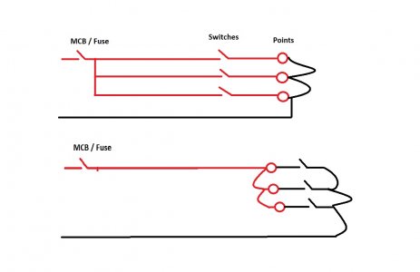

To illustrate the above.- First one is the one specified in the Codes. What is mostly practiced by unscrupulous contractors is the second one.
Another issue is pulling wires of different phases into one conduit. For safety it is not allowed unless it is a three phase load. But these guys do that too to save conduit
