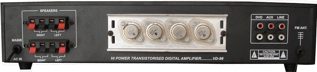

I checked the link you sent via PM (sold by one 'new' seller) and I wonder if 2 pairs of 2N3055 on a tiny piece of metal can run all the speakers you mentioned in your post.

Maybe posting links might get you in trouble but you can post images like this (Images from the flpkrt link you provided via PM)
