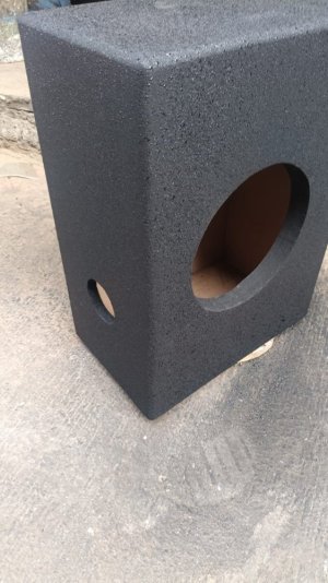

I decided to go with sealed 🤐
JL official documentation suggests 0.65 ft3 net volume for sealed enclosure and mine turns to around 1.2 to 1.3
Is that too large?
That’s not a problem, but it will change the character of the bass compared to JL’s recommended 0.65 ft³.A sealed box that is almost double the recommended volume (1.2–1.3 ft³) will result in:
Lower system Q (more “soft” and smooth bass)
Deeper extension
Less punch and less control
Slightly reduced power handling
Bass will feel more “airy” and relaxed rather than tight
To make it ideal:
Add polyfill / damping material inside (this helps control the cone and simulates a smaller box)
Ensure the box is very rigid and well sealed
Don’t overpower it with a huge amp
If you want to be closer to JL’s design:
You could reduce internal volume with a wooden block or double baffle to bring it closer to 0.7–0.8 ft³, which is a nice SQ sweet spot.
Bottom line:
Your 1.2–1.3 ft³ sealed box is not “wrong” it will give you smoother, deeper, softer bass, just less punch. With damping and clean power, it should still sound very good for your goals.
Work in progress...
