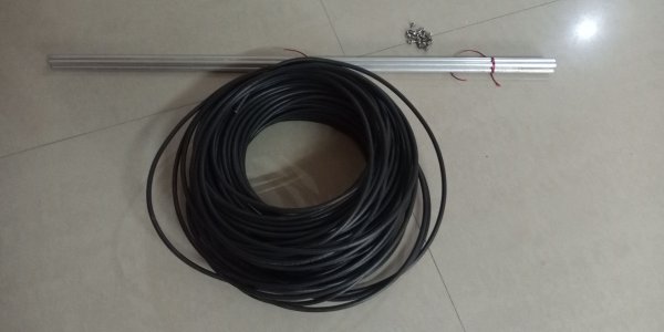

I am going to build one for my home in Madurai. I purchased the components as per the video given on YouTube. There are still a few more that I will buy locally.
In the south of TN, our benchmark for long-distance FM reception is Thendral FM from Sri Lankan Broadcast Channel (SLBC). I am hoping to get it as Madurai is 200km away (air distance) from SLBC.
I will let you know once I complete the installation.

Wish you good luck to catch SLBC. I'd cover all the joints with a waterproofing tape or compound. Atleast grease to prevent water ingress and corrosion. Especially that cable connection is bound to corrode due to Al-Cu galvanic cell formation, cover it or not. Covering will reduce oxidation. If you got a strip of Al-Cu bimetal sheet use it. Al side on the Al tube and Cu side solder the wire.
Not sure if RG6 is available in CCA wire. Then you can try to scrape off the copper and attach the Al core to the Al tube.
Oh.. you can tin the copper wire before joining to the Al tube. We do it when bimetallic strip is not available to connect Al cable to Cu busbars or terminals

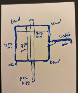

I would try to eliminate the joints .
Get a 3m long Al tube if available. Mark centre and at 375mm from center to each side Bend to U of side 750mm. Pass open ends through the PVC pipe as in the video (top and bottom), bend again to close the loop with sides 750mm. Connect wire at the open ends and seal the connection. Hope you got my idea .
If I am right, it would look like a lengthy loop antenna? Any pictures that you can share to help me understand it visually?
Got it. Instead of screwing the pieces, it's one single tube but bent to look like the similar one mentioned in the video
Exactly... You can try to get copper tube from a/c mechanics or HVAC spares shops..copper comes in rolls. It may be costly though. Of course it will also form patina. But better corrosion resistance. Can withstand crows better than aluminium.
Exactly... You can try to get copper tube from a/c mechanics or HVAC spares shops. It may be costly though. Of course it will also form patina. But better corrosion resistance. Can withstand crows better than aluminium.
Got it. Will try that one. 👍🏼
