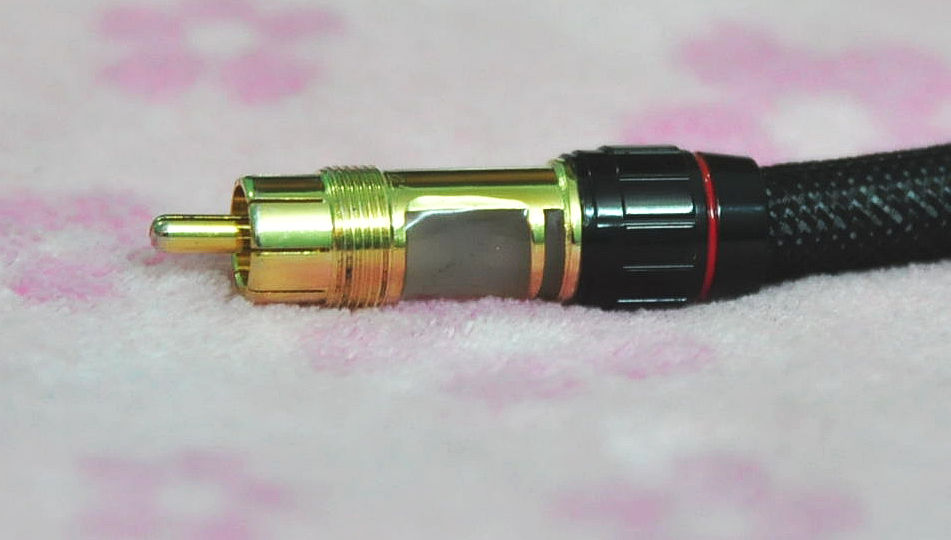

I found out that the connectors are injection molded.
Are you sure it's molded? Not hot melt glue?
Looking at the photo, I am sure it is not injection molded.
IMO Keith & Praveen are right.
Thanks! What is it then? More importantly, how to remove it safely without damaging the IC in order to fix it?
It appears to be a protective sheath. Hold the metal part at the end of the cable with Index finger and Thumb (and middle finger too if required) of one hand and the Plastic thingy at the back with same fingers of the other hand. Twist them on the opposite sides in anti clockwise direction applying light to moderate force. The RCA plug's plastic thingy should turn. If that happens, you continue turning till the jacket comes off exposing the cables metal ends soldered onto the RCA plugs. If not, the jacket is probably fixed onto the metal plug with some glue by the manufacturer to prevent someone exploring the cables.
I think it's glue. As Keith suggested I tried poking with fingernails as hard as I could (and I can use my thumbnail as a screwdriver :lol:) and this is what happened.
http://farm3.staticflickr.com/2828/11474948974_a8d92178a8_o.jpg
Whatever material it is that has been used in 'packing' this stuff (so no one can poke around) it's hard as stone. I could barely leave some marks on it by poking hard. I don't think it's easy to undo, unless one knows what material it is.
I'll go to an electrician and ask him to try soldering iron on it and see if that has any effect on it.

X-ray is may not be useful as it cannot pass through metal. CT scan should be fine, provided you can get it done on an industrial CT. Its a very costly process, in my opinion there are about 2 or 3 machines in India.
IMHO it appears that they have used silicone to seal the.
Try to scrape the sealed material on the surface with a sharp blade. Then try to melt the scraped material in an open flame, if the material melts you can try it on the connector.
A word of caution do it carefully so that the cable should no get damaged.
As others suggested it is better to check the cable with multimeter and then cut the defective connector and rejoin it
