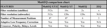

One word yes, it is a lot better than anything available in the budget. I bought my Denon x3700 solely for this and Pre out capabilities, was a wise decision. Like everyone said there are a lot of customizations available.
This is the difference between each version:
