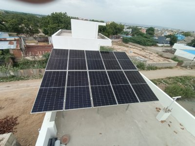

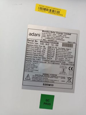

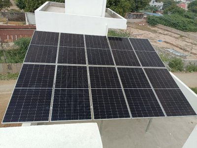

Hi, just finished installing 5kW Grid-Tied Solar System (Three Phase)
Location: Andhra Pradesh (Tadipatri)
Panels: Adani 535W Mono Perc Half-cut (10 Panels)
Inverter: Polycab 5kW
Total cost: Rs 330K
I'm waiting for Bi-directional net meter.
Total cost: Rs 330K
3.30 lacs total cost including all interactions with APSEB and commissioning? was it through a company or DIY types taking help from friends and family? Sound right. I am paying more as am going through a reputed company
Also are you applying for subsidy? how much is buyback price for unused power?
Not DIY, it is through a company. Buyback rate is Rs 4.10 per unit. Subsidy is only for Polycrystalline panels.

Hi all, i just got my on the grid 4.45kw Solar installed last month - All luminous mono panels (10 nos. ×445watts) plus 5kw luminous 3 phase solar inverter, wiring, Earthing, Fabrication and installation plus application form fee all working out to 260000+65000+10540=3.35 lakhs. Each panel costs 19k for the 445watts and about 23k for 535 watts. I went for 445 as it would be even numbers and readily available stock with thd vendor.

Last week my 540*9=4.86 KW was installed along with inverter. ACDB, DCDB...etc. Till BEscom approves increase of sanctioned load, just have to sit and wait. Have escalated to their chief engineer and it is moving a bit faster...but still weeks away till I can actually use the solar power. Very very frustrating. So 3.35 lacs for 4.5 KW compares favorably with 3.6 lacs for 4.86. In my case the vendor has offered to do all the communication with Bescom post which I will give him the remaining one lac.
