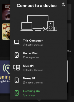

Using laptop is cumbersome. Also spotify playback on any device can be controlled from spotify app running on any other device, bet it a PC/laptop/raspberrypi/ipad/macbook. That's the beauty of the spotify app vs something like apple music.

@Bloom@83 AARGH. I stand corrected. The mobile device don't run spotify service. If you are running spotify on phone or tablet, it cannot be controlled from any device other than the mobile device itself.
When spotify is playing from my phone, i can control it from my browser on my desktop. I can start / stop playback, change tracks etc
He is asking the other way around. If the iphone/ipad/android mobile is connected to the DAC, it cannot be controlled from any other device

Spotify player can be operated independently from the device where it's playing is indeed a big advantage as you said.
