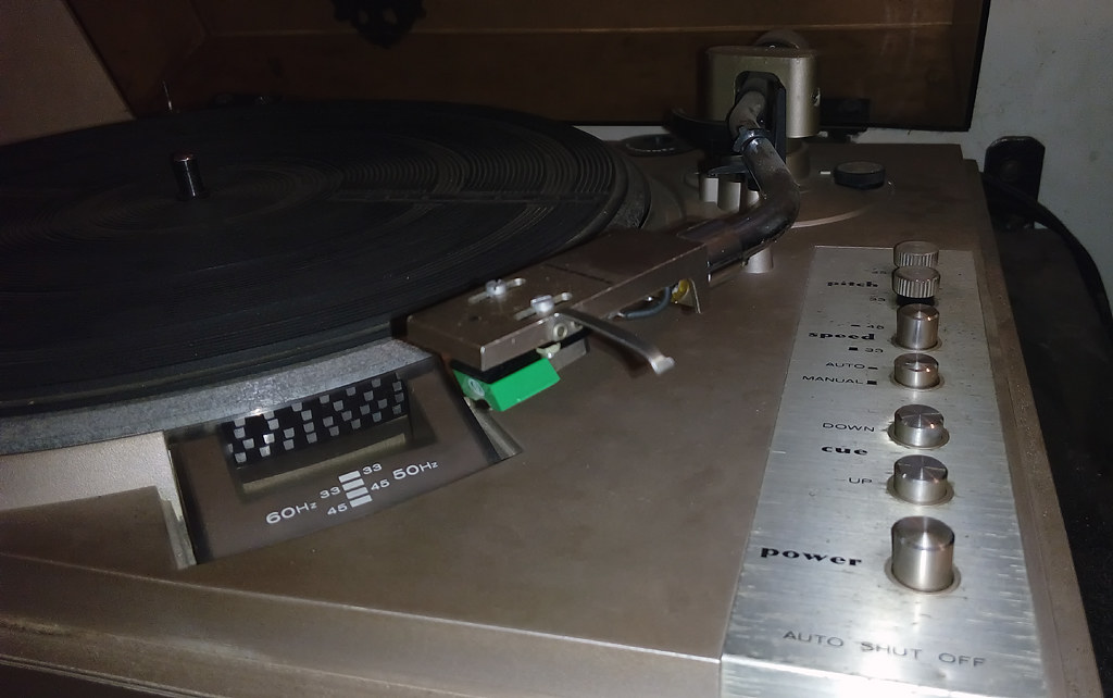

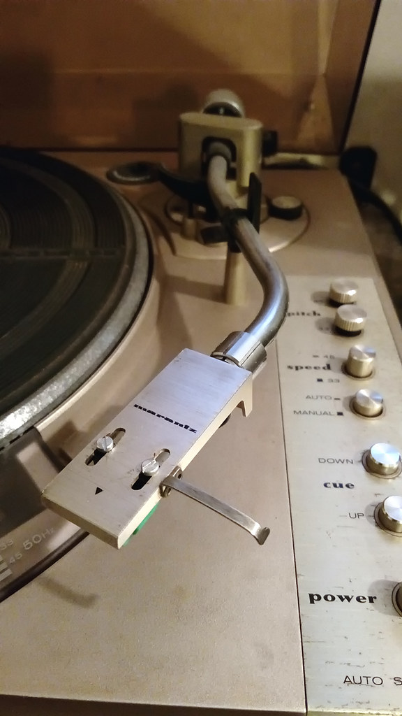

Hi folks, I'm looking for a new cartridge and i've shortlisted a few below after scouring the www. I would greatly appreciate suggestions and advice..
1) AT-120E / AT-120ET / AT-120EB
2) ORTOFON SUPER OM-10
3) ORTOFON 2M-RED
I currently use the AT-95E which is a very musical cart( excellent VFM)
hello OP,
Would you know the mass of the tonearm? While the Denon DL 110 will work with a light tonearms (8 gms) such as project, it is better with a slightly heavier medium mass tonearm of 10 to 12 gm. My guess from looking at te picture is that the tonearm would be about 14-15 gms. If so the Denon will work very well. You could also check at VE for the cartridge compliance and tonearm mass maths of the various other cartridge options being considered, if you have not already done so.
