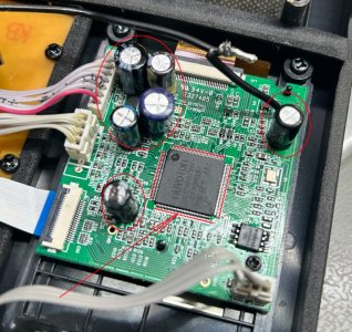

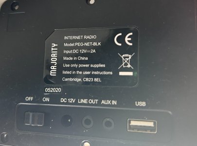

Hi All! I have MAJORITY PEG-NET-BLK, exactly the same model as mentioned here. The problem is when you turn on the radio it starts booting until half of the line and then reboot. And this happens unlimited times.
The problem is not with firmware. Electrolytic capacitors located on the main board just behind the LCD are depleted. Most of them have Vloss more than 4% and ESR more than 10ohms. Some of them are completely dryed, so tester shows unknown element. I replaced all of them with good ones. You can see new capacitors on the picture below.
It seemed to me that the soldering of the microcontroller was not very good, so I soldered all its contacts as well. After that all works fine. Hope it will help you too.
Please use attached firmware if you have problems with it.
Do you have the Capacitance value, Voltage, ESR, Temperature ratings for these, would make it easy to replace?
