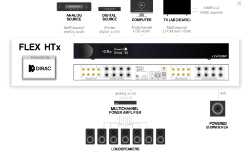

The Flex HTx is the bigger brother of the Flex HT, targeting the need for a multichannel processor with HDMI ARC/eARC capabilities and stellar analog and USB audio capabilities. Within a single rack unit, we packed all the possible connectivity we could fit.
Eight-channel audio input is via analog audio (RCA and TRS), eARC linear PCM over HDMI1, or USB Audio. Additional digital stereo input is supported over SPDIF and TOSLINK optical. Internally, we’ve provided a full suite of miniDSP’s flexible routing and audio processing features: bass management, parametric EQ, crossovers, advanced biquad programming and delay/gain adjustments. In addition, the miniDSP Flex HTx is software-upgradable with full-frequency Dirac Live®, the world’s premiere room correction system.
Continuing miniDSP’s focus on affordable high-performance audio, the Flex HTx features class-leading low noise and distortion figures. An OLED front panel display and volume control/encoder knob provides easy control.
The miniDSP Flex HTx is the perfect solution for a modern compact processor for home theater and multichannel sound.
REMINDER: Please note that the Flex HTx does not support bitstream (e.g. Dolby/DTS) decoding. The audio source must be able to output linear PCM (LPCM) for multichannel support over HDMI.

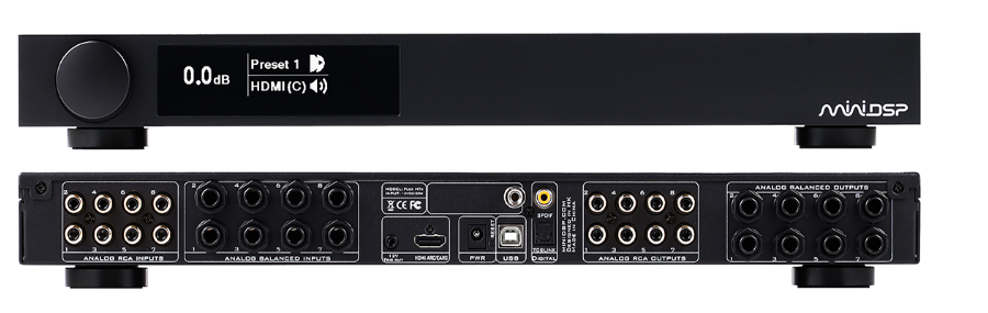

Hardware Features​
  • Processor: 32-bit floating-point 400MHz Analog Devices SHARC DSP
  • Multi-Core USB Audio processor (XMOS)
  • HDMI EARC/ARC interface for multichannel audio in PCM. Note that Flex HTx doesn't support bistream format (Dolby/DTS encoded).
  • Optional upgrade to Dirac Live® 3.x Digital Room Correction, Multichannel (8ch) Full Range Room Correction (20~20kHz)
  • Audiophile performance with very low noise floor and distortion (SNR @127dB(A), THD+N @ -120dB (0.0001%)
  • Inputs: Stereo digital (SPDIF/Optical), Multichannel USB Audio streaming (up to 7.1)
  • Outputs: 8 channels audio duplicated to unbalanced (RCA)
  • White/Black OLED front panel controller with IR control
  • Control and configuration by miniDSP Device Console (DC)
  • Rack mountable with removeable rack EARS

Not an AVR challenger. It doesn't have DTS or Dolby decoder.
Sorry for the noob question. how does this fit with an AVR?
I guess, you need to send the pre outs of AVR to this device.
Not really, due to lack of bitstream support.
I would think of this device as sitting between AV processor and power amp.
Let AV processor handle Dolby/DTS decoding and let minidsp do room corrections/eq/dsp etc.
