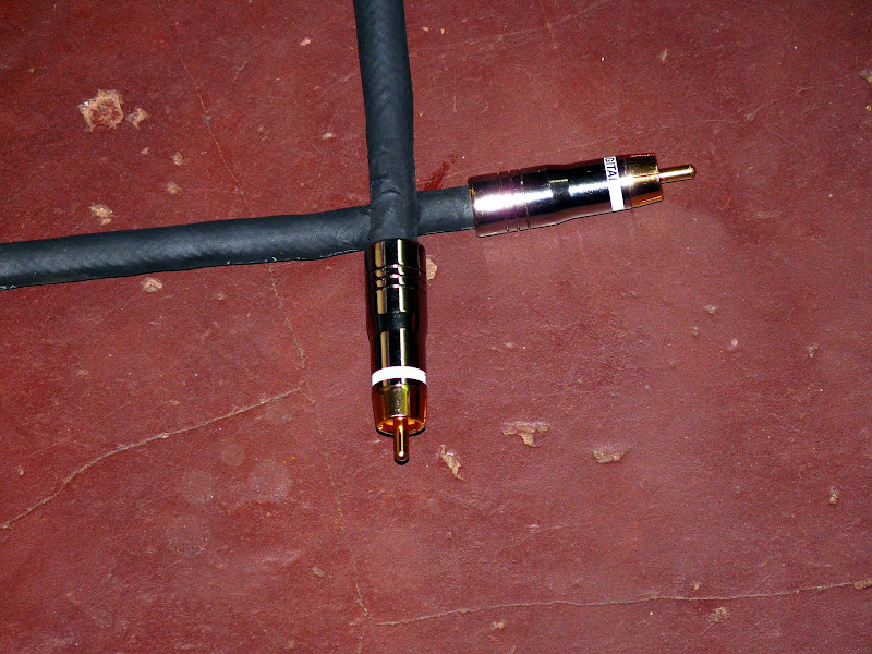

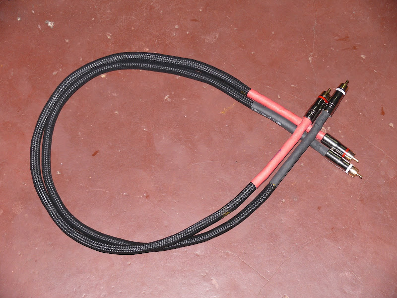

Guys its finally done ! Today I was able to get a decent quality RCA's for the cable project !
This is the top quality that I could afford
This IC project was started sometime back and due to various reasons was never able to finish it ( the latest issue being the RCA's) !

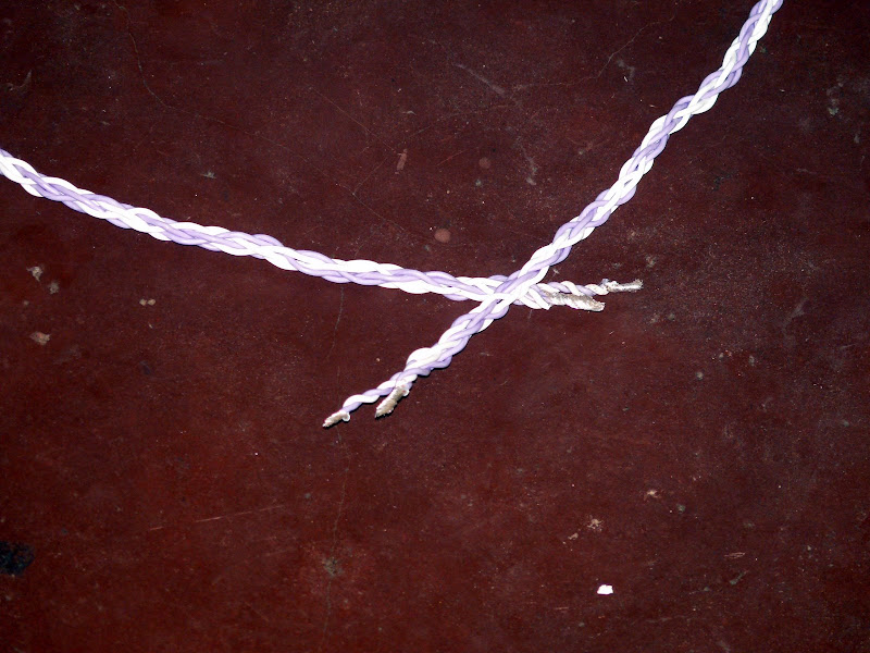

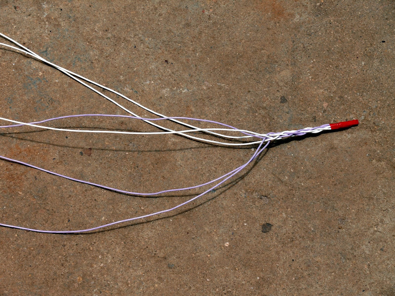

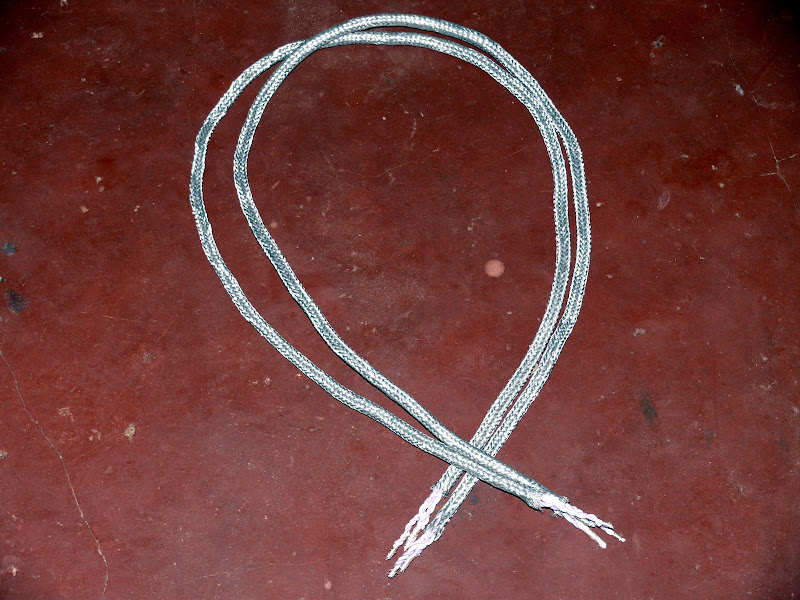

Some details of the cable, I've used 18Gauge OFC with 5Micron's pure Silver coating,the outer layer is Teflon (obvious choice ). I have used 6 wires per IC and have braided them in my own tried and tested method ! The length of the cable is 1 Meter .

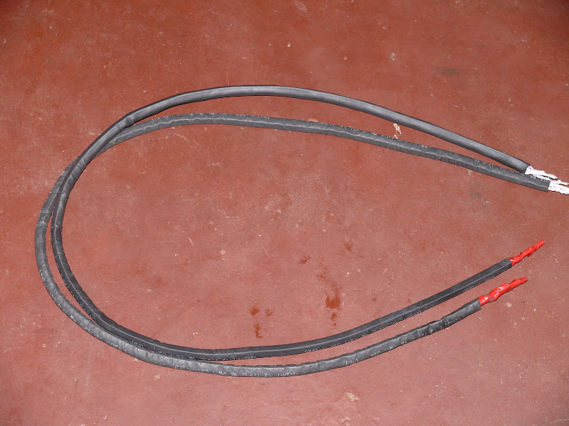

I have also used the Braided Shielding to cover the braided wires and avoid any possible external interface.
Above this I've used a Heat Shrink tube to sort of suck out all the air and make it Vacuum ( although its very very effective but may not 100% Vacuum ).

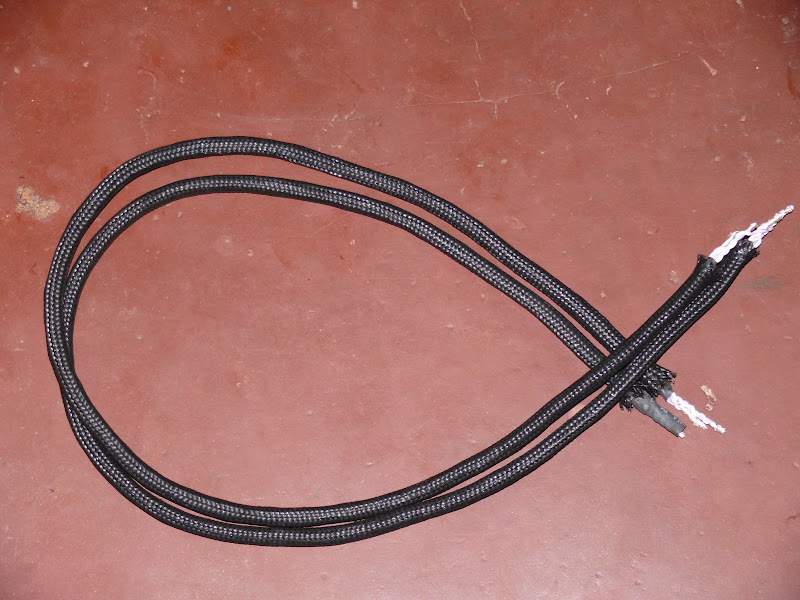

Next is my customary Nylon Braid for dust proofing and other purposes besides making the cable look Very good

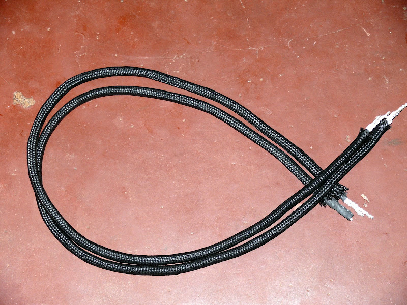

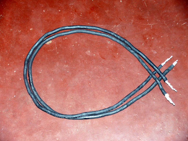

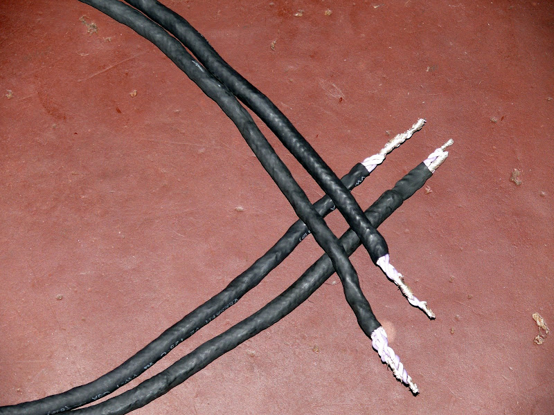

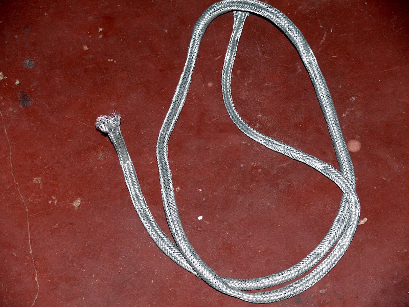

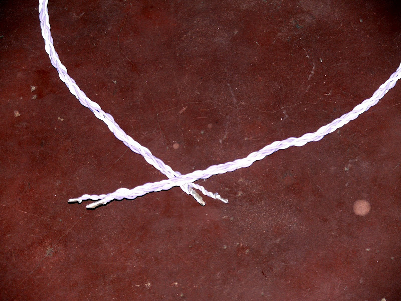

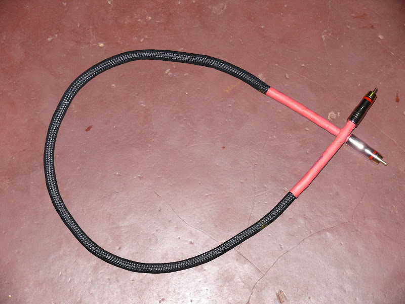

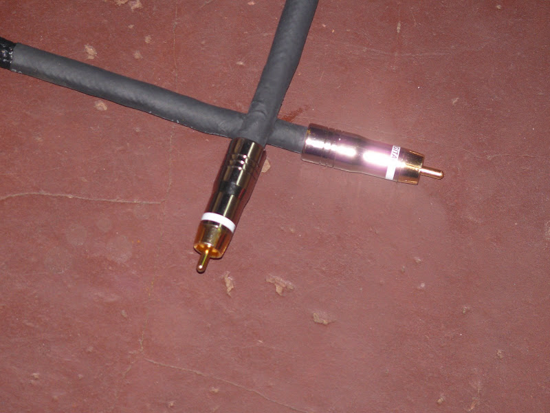

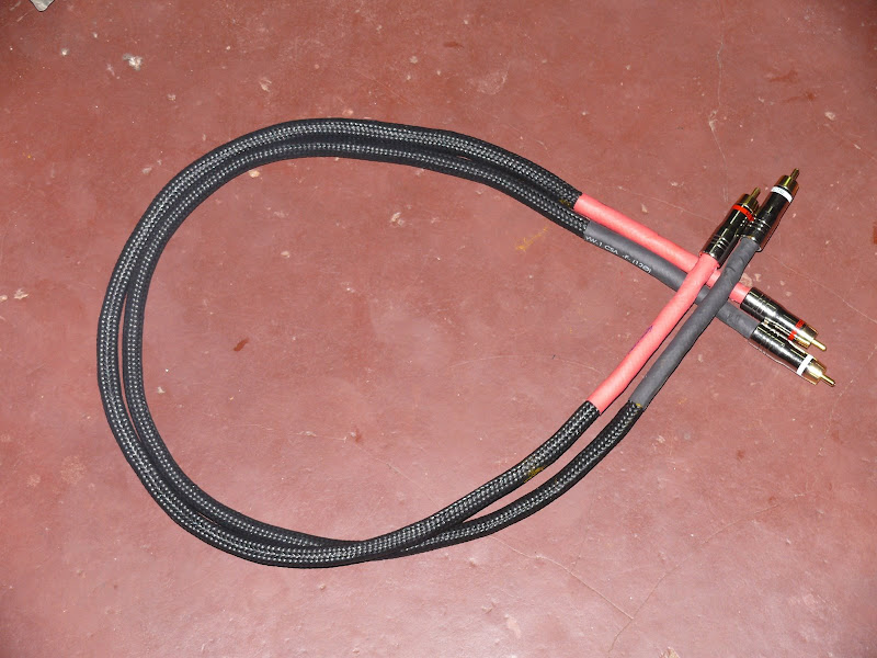

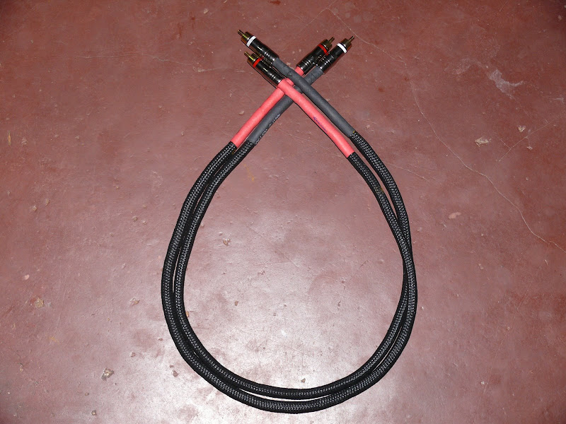

Below are the pics of the cable in different stages !
Continued.................
