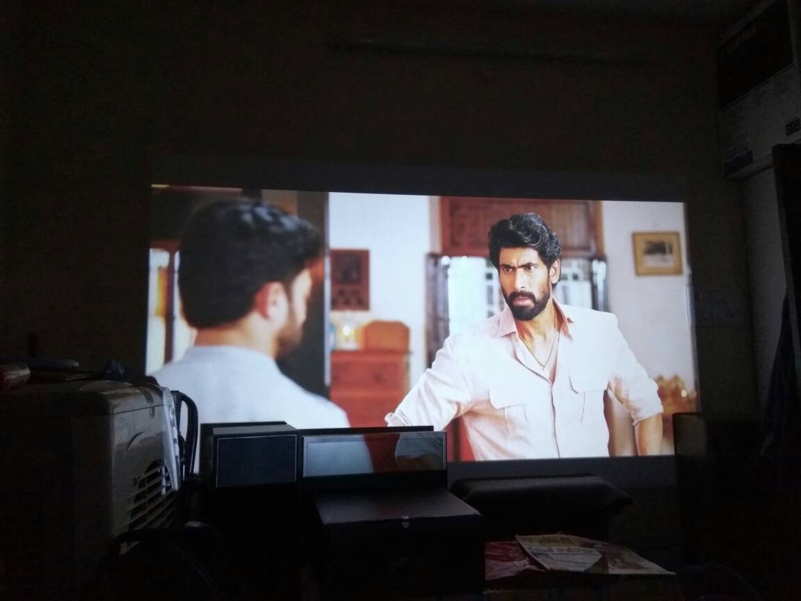

Day time shots in movies are surely very good for the pj and its price range. These below pictures are with default settings. They are pretty good. Night time shots in blue shade on the actors faces are not sharp. That too...i just checked only one movie from amazon prime.
Blue generally blue color has more scattering character. Thats why the sky is blue. I have to tweek some settings.
And these pics are taken with my redmi note3. It doesnt have a great cam
These are Good images for a Streamed Content, And low budget PJ. Though I feel the color accuracy can be improved. Just check your own or family member pictures and try to match the skin color or items in your home etc to the actual one ( Remember the Camera should be of good quality or a DSLR as well). Ideally the other settings should be changed with a blu-ray disc video instead of a download content.

Hi drkrack, actual pj performance is slightly better than the images i posted here. But again, i didn't tweek any settings. I hope it can be improved further. Since im a beginner for pj, im quite happy for now. :eek:hyeah:
