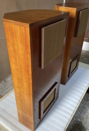

Above is taken from Sadik’s post. This is how the speakers look. The bottom one is the ARU and the top one is the removable driver cover. I remove it when in use.

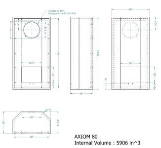

Yogibear, Sadik has the diagram. I had only given the build plans to him. He can share it with you. I don’t have the diagram. You can reach out to him. Nothing secretive about it.
This cabinet is designed specifically by Goodman for the Axiom 80 driver. They designed cabinets specific to each driver they manufactured. Also the ARU design is specific to each driver. So am not sure if it’s a universal design where you can fit any driver. But if you wish you can try FWIW.
Beautiful ! You are enticing me to build a prototype and try some fine drivers I have.
Possible to share the build plans if it’s not copyrighted or something ?
The Axiom 80 is a very high compliance, high Vas and low resonance driver which is suitable for this type of box design which is aperiodic. You can succeed only if your TS parameters are similar.

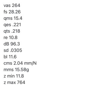

Above is T&S parameters of Axiom 80 that someone measured and put it up on another forum. No idea if they are accurate.
From what I have read, Ted Jordan, the designer of Axiom 80, did not believe in T & S parameters.
