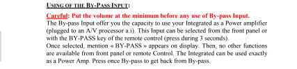

The amp has an array of RCA inputs (aux, CD, DVD, Tuner) and a pair labelled by-pass.

I used a 3.5mm to RCA cable as suggested by @gourav (above), set TV to External speakers and plugged RCA to By-Pass on the amp.

It should be connected to the aux in in the amp

It has to be connected to Aux which i mentioned above. In Bypass you have defeated the volume control and could have damaged the speakers.
Edit- not necessarily damaged but could have damaged in worst case since it was at full volume.

Good to hear the speakers are fine.
You can safely use Tuner or Dvd input on the amp for the Tv.
The bypass inputs will act as power amp input in your case. Did you try them.
Yes, I did try it and it was shockingly loud. I could not use the TV volume control as I had set to “external speakers”
Lucky I did not blow the drivers in my Harbeths!!! Quite a silly mistake. I will try with the other inputs and see how it sounds.

Only indicates that setting to external speakers mean that tv outputs fixed full volume. You should look for some setting in the tv output where it disables the fixed output.
