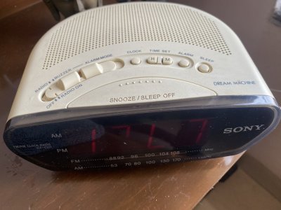

I bought an old Sony Dream Machine radio clock off eBay a few years ago. But when it arrived I noticed the volume wheel didn’t do a thing and the volume stayed at full level all the time. I didn’t get to addressing it as I wasn’t using it and had kept it away.

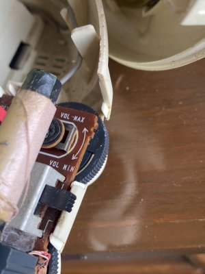

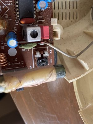

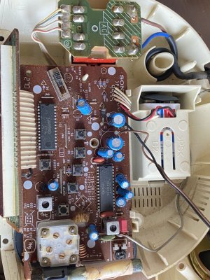

However, my concern is whether the local repair shops would be able to repair it. I myself don’t have any knowledge of electronics and need advice of the knowledgeable members here. I am posting below some pics of the radio opened and the volume wheel close ups so you can undertand what kind it is.

As surfatwork as mentioned that is a trimpot. It is not a normal potentiometer that is typically used for volume control. No wonder it has gone bad. Trim pots are not meant for continous back and forth movements every day. However, these trim pots are easily available in electronic shops. What I'm not sure is how the volume control knob is attached below the pcb.
Thanks @surfatwork and @mbhangui ! So both of you think that replacing the trim pot is an easy job and I can get it done from a nearby repair shop without an my risk of spooling the audio quality? It gives me some confidence to take it there.
Whate I'm not sure is how the volume control knob is attached below the pcb.
Do you think it could make the job of replacing the trim pot more difficult/ riskier because the whole PCB would need to be removed to replace the trim pot? Pardon my ignorance here.
Do you think it could make the job of replacing the trim pot more difficult/ riskier?
Yes it is an easy job. You can ask the repair guy to replace it in front of you.
