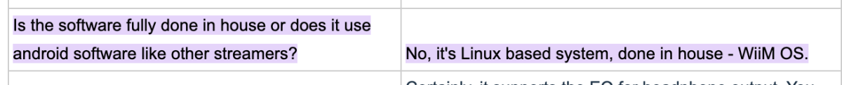

Fun Fact. wiim is linux based. Not android and not windowsScreenshot 2024-07-19 at 23.04.57.png
