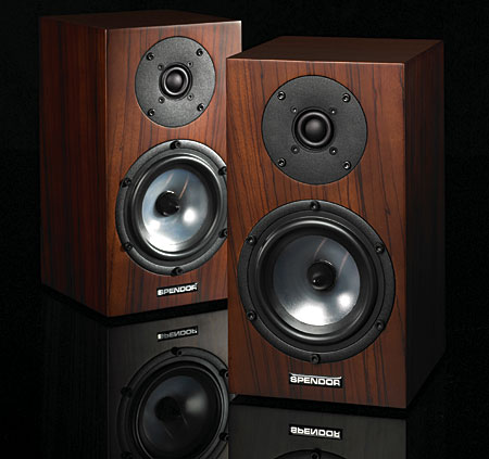

A brief of my Stereo Setup first. I have a dedicated room of 12 ft X 12 ft (there are few other stuff like single bed, book shelf etc). The chain is, NUC (Roon Core) -> DigiOne Signature -> Chord Qutest -> Karan Acoustics KA I 180 MK2 -> Spendor SA1. I bought these speakers in 2014 and since then it has really served me well. I really like these speakers and feel that for my room size they are perfect. Though, I do miss Bass a bit. From last few weeks, I have been researching about adding Subwoofers into my setup. I have also gone through few threads in this Forum, where people are seeing very good results with adding Subwoofer into their Stereo Setup with the similar kind of Speakers. I came across Graham Audio Sub 3 (Passive Subwoofers) which matches beautifully with Graham Audio LS 3/5 and LS 3/5 A speakers. My SA1 share the same design as these speakers. I think, these Sub should match with my speakers as well.
I seek opinion and advice from Audio Gurus here, whether this would be right thing to do.

Spendor SA1

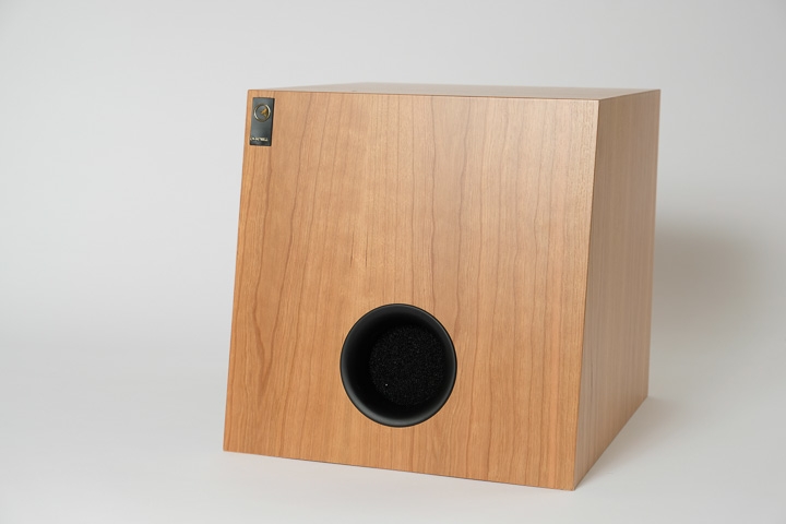

Graham Audio Sub 3
Kannan
Jan 13, 2008
2,232
Chennai
it is a passive subwoofer which means you need to add a monoblock amplifier with inbuilt DSP to control crossover, slope and attenuation.
For your current need, an active subwoofer is a better solution, and one subwoofer should be enough.
Depending on the design, you can either take low level output from your chute or the record output from the amp ( which I think is just a paralleled output of the input section) or high level outputs from the amplifier to the active subwoofer inputs.
Crossover, attenuation etc can be set in the sub.
Some REL models are well received for music integration, there is also an Elac model with bluetooth-enabled auto room calibration in built.
Overall, I suggest taking the active route.

Thank you for your advice. Apparently, this subwoofer is to be connected with the existing Amp and sits in between Amp and Speakers. It has a crossover and it passes signal above 100Hz to the speakers.
But I agree, that active Sub is more successful addition to the Stereo chain.
That is good but to be fixed at 100hz could be a handicap for your setup. The crossover point should be adjustable from @atleast 45/50hz.
