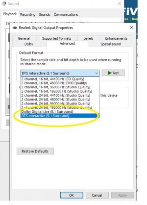

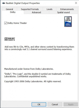

It was little bit tricky to get 5.1 enabled on mother board.
I had to download some Realtek driver from internet.
My mother board is Asrock Steel Legend B450.
