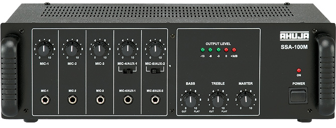

my second son was having fever through the night, hence I cancelled my plans for the day, went to church in the morning and collected the bigger amp and brought it home for servicing and modification. The pots needed a change, the reset switch has ceased, bias needed a check and the Parish priest had requested a mod as the amplifier generally had a very boomy signature (even with the tone controls in flat position). Got all this straightened out, while I kept the little sick man engaged. Here are the pics:

Am down with a sore throat and fever today (with the kids) but did not want to lie and bed and kill time. So drove by the church and picked up the second amp (the 100watt one). This is an older amp and when I opened up, it looked like it had been through a world war. The feedback from the parish priest was that this amp sounded very dull and muffled. Also after the 250 watt amp was installed this morning, the difference between the two was like between a colour movie and a black and white movie. This called for some hot-rodding

A simple mod for speech enhancement, a permanent presence control:
Another hot-rod mod, increased the trebles a bit (it sounded very dull otherwise):

A typical circuit:
My version:
I should actually call it a loudness control rather than presence.
But why would you need that "presence"/"loudness" mod - the amp has bass/treble controls which could be used to boost the treble, at low volumes right?
Yes but the amp has 2 sets of level controls, one for each input and a master volume control. The loudness control enhances the vocals (the feed comes from the processor).
I think I can see why they call it "presence."
Loudness controls boost the treble and the bass, the areas in which our ears become less sensitive as the volume drops. but presence is in the mid range where vocal frequencies are to be found, so it is sort-of opposite to loudness
