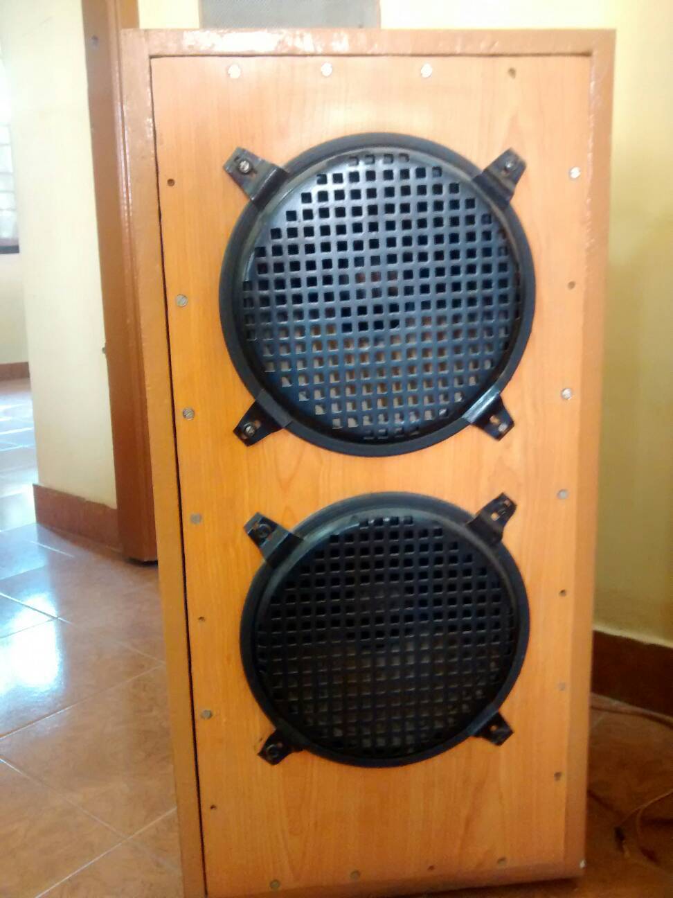

Speaker boxes back form the carpenter's
He's done a fantastic job in making these look like the other Ahuja speakers in the church. Now I have to screw in the corner caps, wire up the drivers and mount up everything. Have changed the original logic and cross overs and will be customizing these for PA use with double LF drivers per box.

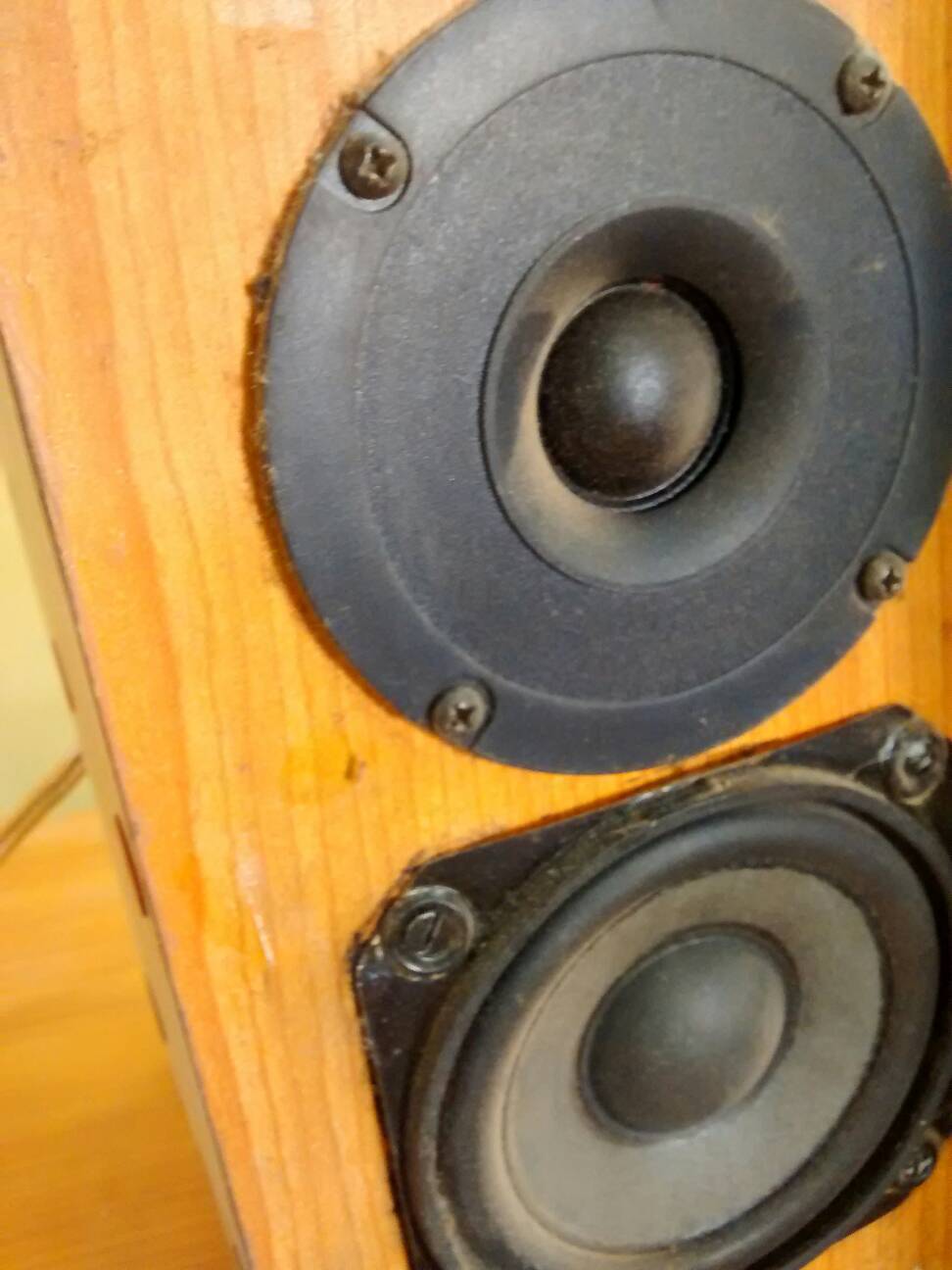

First glimpse of the speaker boxes (Simon, recognize these?):
Excellent work, Reuben..It has come out very nice, indeed
I truly appreciate your spending's on time,money & effort!
See if you could fasten the mid-range speaker to the main box..Else, in public places, people may meddle and dislocate it.
