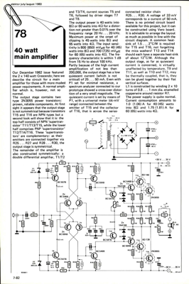

You can follow up this link to see the details of this fantastic amplifier....
