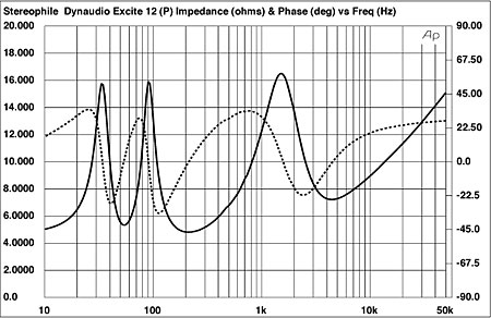

Nominal impedance usually represents the lowest impedance value a speaker goes down to.
Actual speaker impedance varies with frequency and is usually shown with an impedance curve.
When playing music impedance value depends on the frequency range being played.
See the Stereophile impedance plot for Dynaudio Excite X12 which is specified as a 4 ohm speaker
