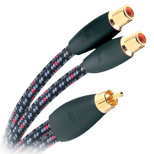

Alright guys - thanks for the links. All this leads me to conclude:
If I really need to achieve what I set out to do, I could use a stepped attenuator as a passive pre-amp for the main volume control. There are 2 configurations I could use to wire the 2 channel output of the pre-amp to my 2 integrated amplifiers. Both configurations would need the use of a Y-adapter [one male RCA jack terminated with two female RCA plugs].

Anyone know where to buy Y-adapters in Mumbai?
Also found here.
The way I see it:
1male-->2females - Horizontal & Vertical Bi-amping
There will be 2 relatively long cables going from the females of the Y-adapter to the amplifiers
1female-->2males - Vertical Bi-amping
There will be 1 relatively long cable going from the female of the Y-adapter to the female of the pre-amplifier
1female-->2males - Horizontal Bi-amping
There will be 1 relatively long cable going from the female of the Y-adapter to the female of the pre-amplifier. The problem may be that the 2 amplifiers need to be very close to each other for the 2 males to reach 1 female each of each amplifier unless the Y-cords are long enough.
1 Male --> 2 Fem : Used on the Preamp's output side
1 Fem --> 2 Male : Used on the Stereo Power amp's inputs
With what you say - isn't what you mention above incorrect?
Preamp outputs = Female hence cable terminations at this end will be male. Other end of this cable will be male too which will terminate into the female end at the leg of the Y-adapter. The other 2 terminations of each end of the "Y" will be male which will terminate into the left and right females of the power amp.
@ keith_correa
1 Male --> 2 Fem : Used on the Preamp's output side. What I meant was that the Y-adapter is used on the preamp itself with the single male going into the pre's output
1 Fem --> 2 Male : Used on the Stereo Power amp's inputs. Now here, the Y-adapter is used on the amplifier's side with the 2 males into the amps inputs
Hope this clarifies your doubts.
Had no doubts. Was confused by your post.
Ah, I see it now - you are giving 2 options. Had no doubts on options but Thanks all the same.
