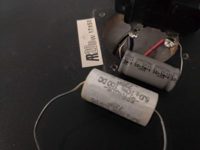

I once "upgraded" the electrolytic crossover cap in my ar28b speaker to a film, and the character of the speaker changed completely. It went from warm and smooth to bright and harsh. Aging caps in the signal path will probably tend to make it warm and smooth as well, which may be what you're missing.

The electrolytics were stock. I replaced them with Sprague film caps FB_IMG_1656516236916.jpg

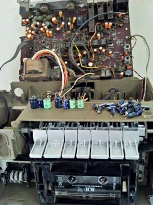

On another note, i replaced every electrolytic in an old Technics tape deck with a keltron just for fun and noticed no difference. The technics had all Japanese branded (mostly nichicon and Nippon chemicon ) caps

The electrolytics were stock. I replaced them with Sprague film caps View attachment 70375
