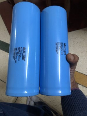

@rwnano Your title says “weight of caps”.
How about these ? I could barely hold both in my palm….
I'd say please be careful while working with these since they can "OFF" humans with their discharge currents.
