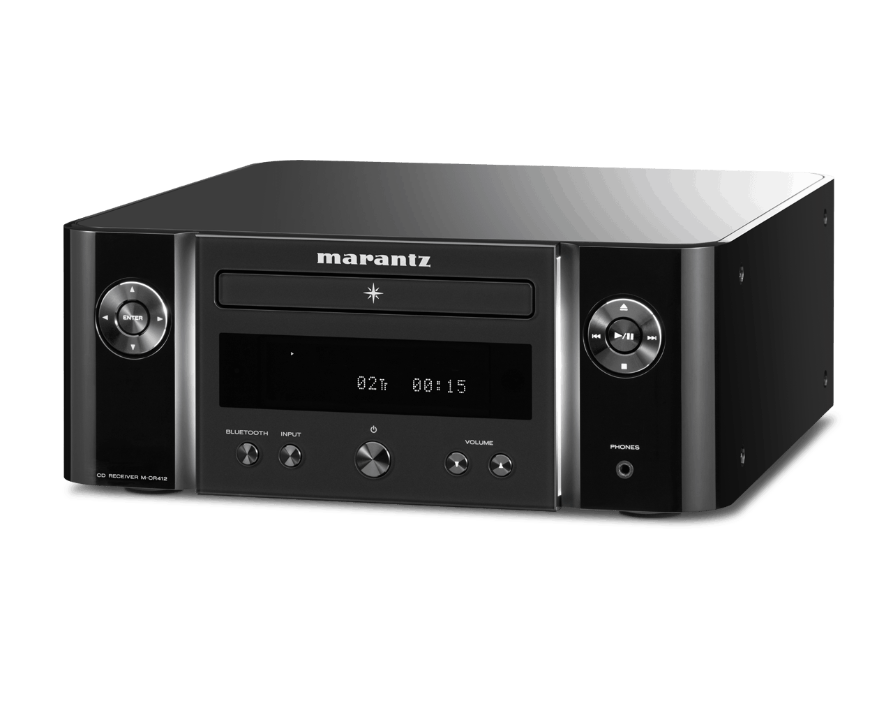

Marantz CR412
Paired with Mission LX-1
You can connect via optical cable from TV.
This combo will cost you around 50K.
