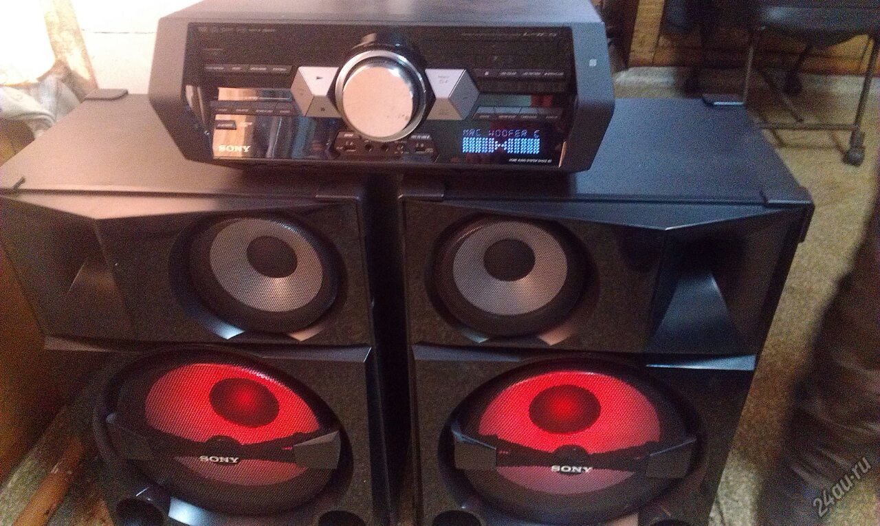

I have Sony Shake 6D :
Specifications
User Manual
Problem is that the AV Receiver is busted and can't be repaired by Sony, now I wanted to build a custom home theater setup 5.2 or 7.2
But I am not sure which AV receiver are their in the market which will work with those speakers as they are very high power rated.
My plan is to use these existing speaker as front left/right channel and it has 2 sub-woofer already in the unit also.
Please suggest a suitable AV receiver under $1000 which can power these speakers.
Also please let me know what center and rear channel speaker would be fine with those Sony 6D speakers under $800 for all the remaining speakers

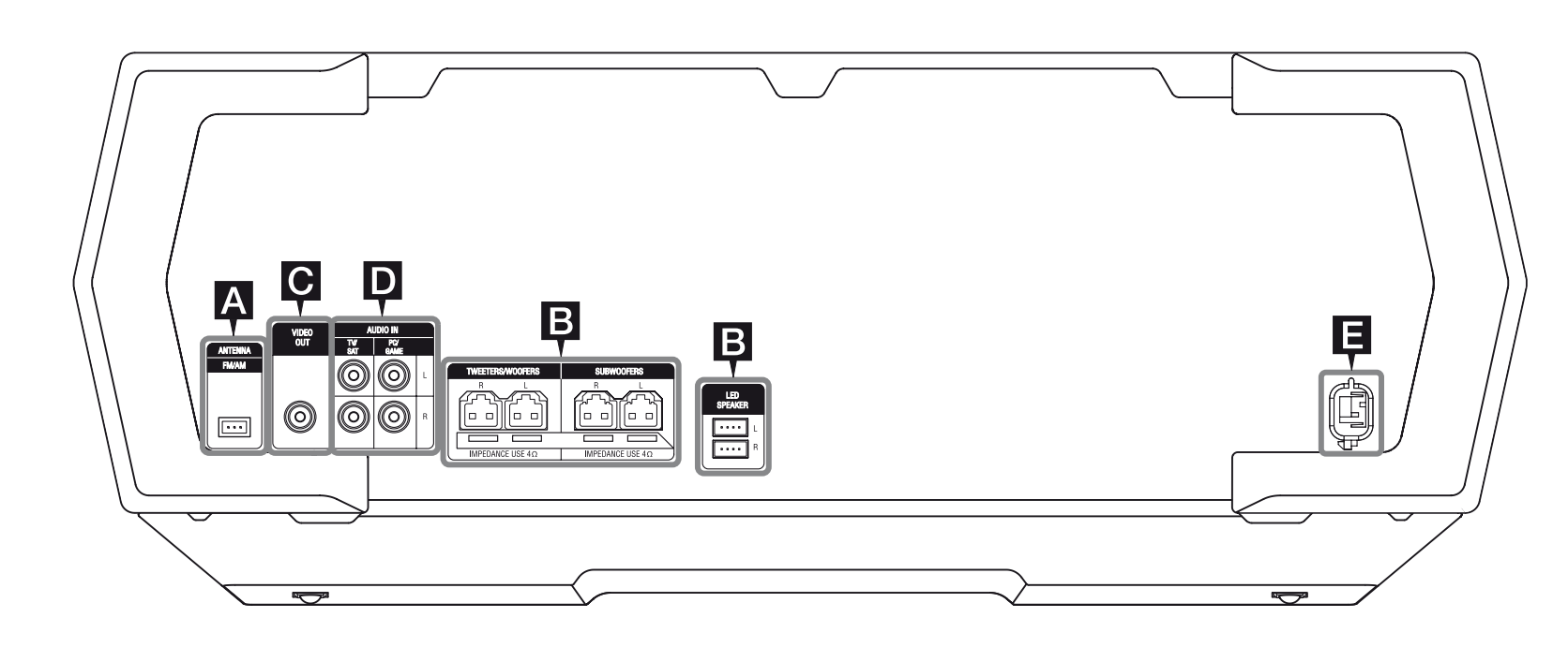

Also these are the wires and back side of console :
Blue one has 4 wires and is for sub-woofer only.
Medium White one has 2 wires and is for woofer/tweeter
Tiny white one is for LED which is just for lights
Also I don't understand how will I connect 4 sub-woofer wires to the new AV receiver or amp? I thought all sub only had 2 wires
Blue is for the sub and the midbass. The white one for the Tweeter. Led if you need you will have to work on that separately for its power and driver, maybe do some DIY with a VU meter board.
For speaker wires, you will have to splice them for sure. The White one is for the Tweeter and the Midrange with probably a crossover built into the speaker. These would easy to connect. The issue is with the Subwoofer connector. I am not sure why there are 4. Maybe it's a common connector, the higher versions of the Shake series has another driver. Try getting hold of a Stereo amp and hook the wires one by one and label them. You can look at certain Onkyo or Yamaha receivers which came with Passive Sub out. Those might work with these speakers as the Subwoofer I guess has the crossover in the main unit.
It is not very straight forward, but doable. You will need to experiment a bit.

From the photo....looking at the speaker connectors...it seems that only the Horn tweeters form part of the connector.
The other connector has 4 wires which indicate that the woofer and subwoofer are on the same connector.
Please note that with a new AVR....the LED lights will not work......

I tried to open the speaker but its too tight and I was damaging trying to force open. What I will do is post image of the inside of the AV receiver when I get it back from Sony service center maybe then you could tell me if amplifier is built-in the speaker or AVR and also where the cross-over is located.
There are 4 wires coming out from the sub but they are joining into 2 connectors ultimately, so it might be possible that they have just split the wires into 2 each for positive and negative terminal rather then using a thicker wire.

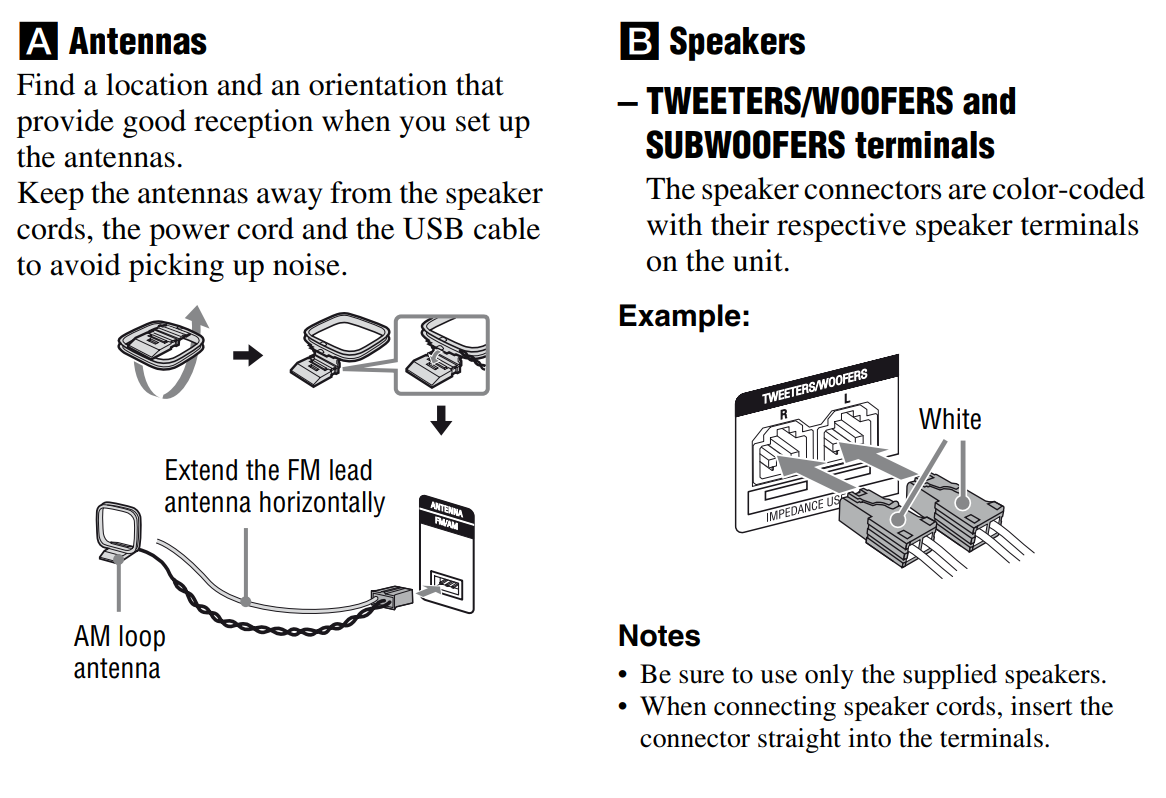

In the manual it says blue connector with 4 wires is for sub-woofer only and big white connector with 2 wires is for woofer+tweeter combined
What do you think?
What do you think?
