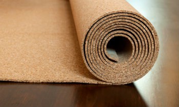

The cloth painting on the cupboard side wall has some cork sheet behind it. Franky I thought I should do something rather than nothing for my audiophile creds.

I bought my cork sheet from a Fort Mumbai shop called Lamtex Insulation (please google) and they were super bemused. It covers absorption also besides sound proofing
