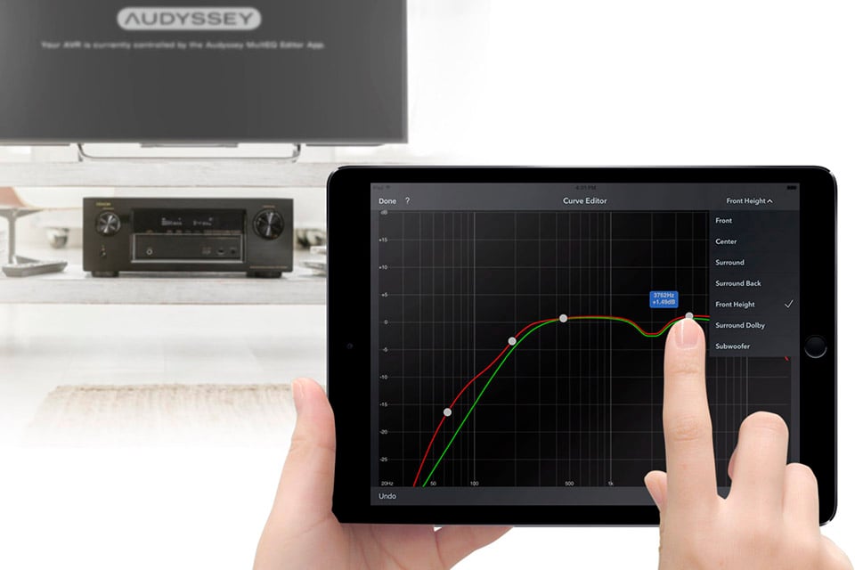

If you have a high end denon there is an audessy tool which you can purchase for iOS / android which unlocks a whole lot of parameters.

@kapvin ah, apologies I misunderstood. I have the Audyssey app- its quite good for tweaking the target curve. These are the results from mine- I still have to tweak the curve a bit.
