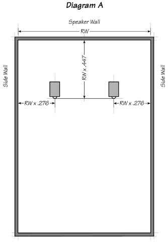

I have this unanswered doubt about the possibility of applying the golden ratio. I hope you or someone here helps me with it.
As the article says, “The distance from the center of the woofer face to the wall behind the speaker is Room Width (RW) x .447”
So, even for a small room of 10 ft width, it amounts to 4.5 ft. Assuming the speaker depth is 1 ft, it means a clearance of 3.5 ft behind the speaker and the front wall.
Now comes the challenge. For mine and most other BS speakers in the budget range,port in the rear produces sufficient bass reflex only at around 1-1.5 ft from the wall, beyond which the sound starts losing bass, weight and emotion. This is at least my experience with my speakers.
Doesn’t that make it impossible to implement the golden ratio for speakers with rear bass reflex port without compromising SQ in another way?
Or is there another explanation?
Sachin, I'm no expert. I merely provided a link to help the fm who needed an explanation on the Golden ratio.
My personal view is that reinforcement from the wall behind the speakers isn't necessary for a good speaker.
If a speaker is deliberately intended by the manufacturer to use such reinforcement, then the golden ratio may not be relevant. In such cases, even the rule of ⅓s would fail.
I do know that many speakers sound best with no wall at all and, for such speakers, it would be desirable to keep reflections and reinforcements at bay. Golden ratio and ⅓ role will then be useful.
I leave it to the experts to provide a more technical explanation.

based on my understanding, these and other calculators are leaning towards getting flat response, both bass and side reflections. Some may like this as well, rest as suggested in this thread, use this as a starting point and fiddle till desired results achieved....
I personally prefer to use cardas calculator for depth from front wall and then customise distance from sidewall based on sound stage.... I like a wide soundstage and depth in image... Distance from front wall plays a huge part in it

Thanks. So, it might result in a shallow low end (for rear ported speakers especially), but will result in a flatter frequency response even if over a smaller frequency range. Yes, the choice will depend on the individual’s preference. Given that I place higher value on the emotionality of the songs, I’d stick to close to the front wall placement. I’ve never enjoyed the better separated but less affective result from bringing the speakers further up. But I can imagine someone say into western classical or electronic music might prefer it.

Thanks! That’s probably not the case with most budget range speakers. The rear port is used as a compromise for cheaper designs/builds with smaller woofers. So, unless I get a significant upgrade, I have to be content with the reinforcement from the wall, and resultant frequency imbalance. At least that puts the mind to ease!

Or pull the speakers into the room and compensate for bass with a subwoofer.

I am running an ATC SCM19 which is a sealed bookshelf in the middle of the room. There is plenty of bass and my musical enjoyment has improved massively!
Clean bass response is something which completely depends on quality of the amplification and speaker.
If the understanding is that speakers with a rear port are only or majorly affected by proximity to the rear wall then that is a fallacy except in the case of a rear ported speaker being extremely close to the rear wall - and we know better than to do that.
Bass from every type of speaker is affected by this proximity due to the nature of dispersion of bass frequencies.

Thanks. Further exemplifies the premise that better speakers don’t need wall reinforcement to produce low end.
It all depends on how the speaker is designed older snell designs around which many Audionote speakers are designed are to be kept near the walls.. Older Klipschorns, Vitavox and even many Tannoys work best in the Corner.
This is not about how the ports are kept but how the speakers curves are.
That said unless specifically mentioned the majority of speakers need the space behind and is more dependent on physics of the Room nodes . This will usually be in the area of 1/3rd but again rooms are first for living and convenience and then for music hence some compromises in the placement are necessary.
This means moving to perhaps 1/5 or 1/7 ( always odd nos) to minimise these nodes
IME it's not only how far is the speaker from the front wall that matters, but also how far your seating position is from the speakers. For instance if your speakers are at 1/3rd location from the front wall and your listening position is also 1/3rd from the speaker, then you will seldom get any room enhancement or lift for the low frequency. Sitting at 2/3rd distance from the speakers can enhance low frequency. At the end of the day is how boomy your speakers are w.r.t room placement. Some times sitting at 1/3rd might work for you and sometimes 2/3rd position will be perfect. You cannot setup a speaker only by looking from the speaker and wall point of view, but also consider your relative sitting position from them.

So, you moved your speakers to 2.053meters from back wall. My room size is 12 feet X 15 feet, so will not get to play around. What can I do?
are you placing the speaker along the long or short wall ? if along the short wall and firing down te long side, start with 5 feet ( 1/3) of the driver from the real and 4 feet of the insides edge of the speaker to the side wall...and try to adjust..
