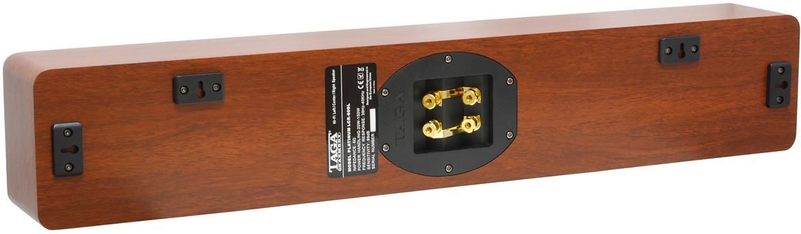

May I know why a 3 way speaker? I am not aware of any which can be wall mounted (I may be wrong though). AFAIK some smaller bookshelves can be wall mounted. You could look for those. That should be doable rather than using puny satellites. Also, have you thought of in-wall speakers? If possible, that could be a good compromise.
1) Price, 2) Dimensions, 3) Dedicated drivers
Am not choosy on any brands in the affordable segment, but like to pick based on the needs..
Design: Left / Center / Right On-Wall 3-way, 5 drivers, Bi-wiring,
Wall Mounts (for horizontal & vertical mounting) 12mm MDF TLIE enclosure
Crossover points 450Hz, 2.5kHz
High-Frequency Driver: 25mm (1), TPTTD, TWG faceplate, TTP
Bass / Midrange Driver: 4 x 102mm (4) TPACD
Recommended Amplifier Power: 20-150W
Frequency Response: 39Hz-40kHz
Impedance: 6 ohm
Sensitivity: 89dB
Dimensions (H x W x D): 76 x 13.5 x 11 cm
Weight (net):
8.5 kg pc. (PVC)
8.8 kg pc. (High Gloss)
