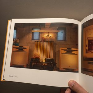

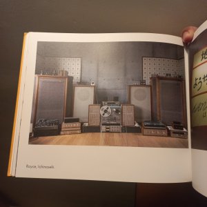

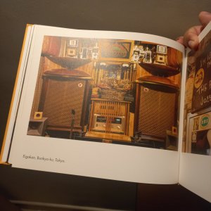

That sounds really cool! I picked up this book recently that's filled with great pics of kissa all across Japan. Highly recommend it if you can find a copy, would serve as great reference point when trying to build your setup.
