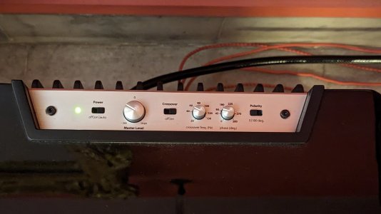

Basic connections aside I was dreading integrating the sub with my SCM20s. I started off with the setting the crossover at 80Hz, phase angle at 45 degrees and Master Volume at 0. The sub kicked in with a stomach churning drone almost immediately. They are fast and can get loud in an instant. Long story short, I ended up reducing the Master Volume a fair bit and adjusted the crossover point to 55 Hz - 60 Hz. I don't know if I am just plain lucky but I was done in about 15 mins. My preference being to use the sub to just feather the low end just a touch.
Initial listening impressions after getting the settings dialed in was just ... wow! I had great sound before (in my opinion) but this was even better. So much for all the hesitation I had about adding a sub to my setup. The low end / bass is all there where needed but it has also elevated the mids and highs. Clearly the LF has some information that complements the mids and highs giving them "more completeness". Bass has more "weight" and definition. I have been listening to my setup all day today. Have played a variety of different genres but have been enjoying some classic rock and soul the most. These genres were always a little harder to get right earlier. The added weight and definition has clearly elevated music that was less involving before.
Will keep on listening and post my impressions as everything settles in. But initial listening impressions are really good. All fears I had of dislocated bloated bass has been eliminated within minutes. But it's early days and will see how things pan out after putting in more hours of listening.

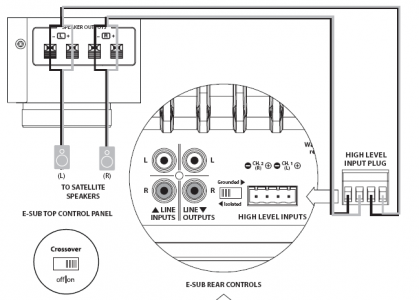

Sub looks excellent Nikhil, and I am sure sounds excellent as well. JL audio clearly states in their manual (against all audio-phoolery, golden ear timing etc. type of advice):
"high Level Inputs
This feature is included for convenience when needing to connect the E-Sub
to a receiver or integrated amplifier that only offers speaker level outputs. It is not
the preferred method when a line-level signal is available."
In fact they are one of the few high end sub woofer manufacturer that recommend this type of connection only and is found in many higher end set-ups. I have heard these subs integrated to Wilson Audio speakers, with line level inputs and they sounded simply superb.
Do consider line level inputs, down the road, if you can.

I am sure both methods will work well Nikhil, one probably will not be able to tell the difference even. I was merely pointing to the recommended method by JL audio themselves, because in the past, many stated that the speaker level was the best way to connect a sub, and if not - one did not know what they were doing and had lead ears.

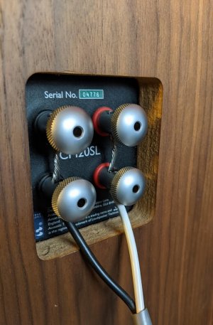

Just try an activity Nikhil, Make the sub as full range as possible and turn off the main speaker connections and see how vocals sound, the more articulate the sound the better it is for SQL. Considering its a sub driver, the vocals will not be clear . Since you reported that the midrange has improved with this, i would not worry too much in SQL..
The problem is that I have my mains connected with bare wire.
Disconnecting them is a PIA at the moment but will keep this in mind.

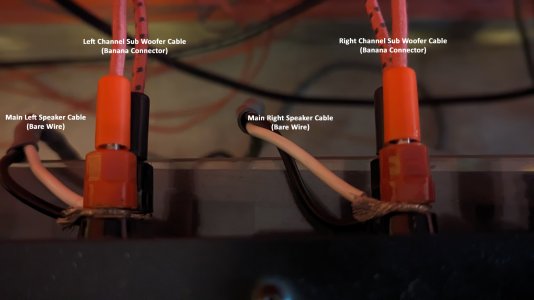

Help me know your amp to speaker connections…. Are you playing your mains via the sub ? By high level signal do you mean signal from amp speaker terminals are fed into the sub-crossover and then fed to the mains ?
No. The sub is connected to the main speaker connectors at the amp.
The main speakers are connected bare wire to the amp.
The sub is connected via banana connectors on the same terminals at the amp.
