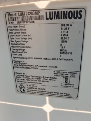

Always look the specifications of solar pcu and solar panels then go for appropriate no of solar panels in a string and require no of string in parallel
For example
Look at back of solar pcu for voc it can support maximum .
Then look for voc of ur solar panel.
Then do accordingly 3 or 4 nos of panels in series in a string and then join 3 to 4 strings in parallel using solar ajb box for a 5kw installation according to ur budget and requirement.
