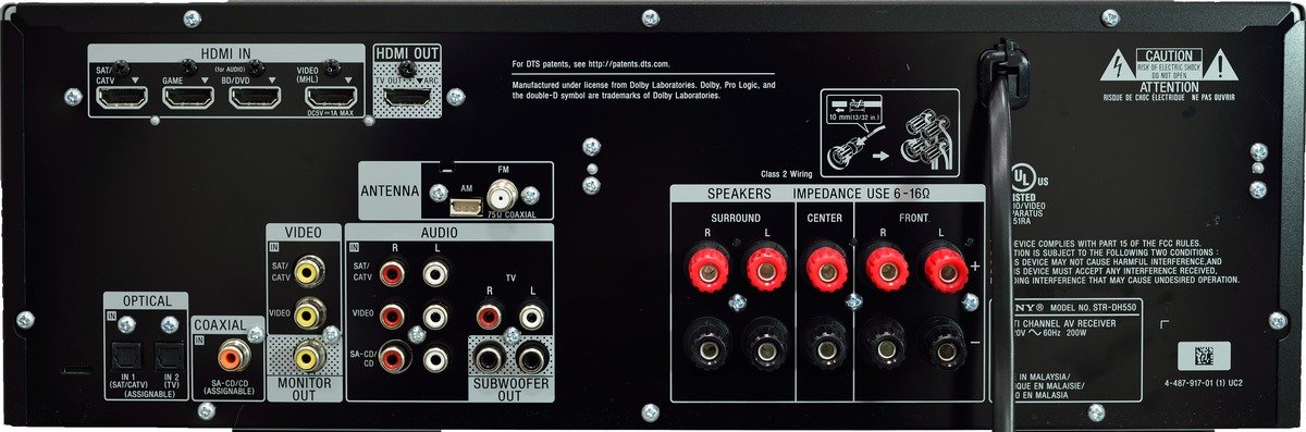

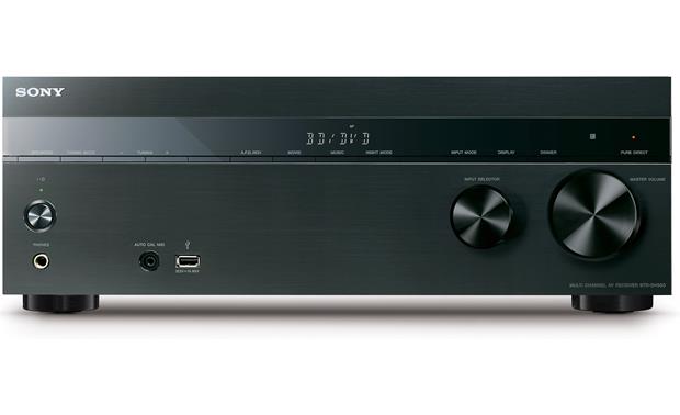

Consider an AVR like this (Sony 5.1)
This will give you multiple devices with HDMI connectivity ( HD STB, Blu ray player, chromecast, etc..)
With the AVR, you can the above pair of BS + center to make it 3.0 set-up.. This will be best compromise for both movies / music..
