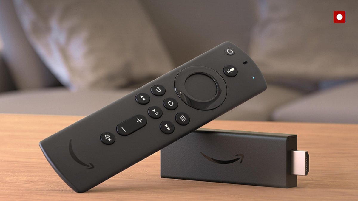

I have a Blaupunkt Sound Bar connected to my guest room TV.
However, I have not been able to pair my fire tv stick remote (with volume up, down, power, mute) with it. A couple of options of Blaupunkt Sound Bar in "Manage Equipment" do not work.
It works well with Samsung sound bar (in other room).
Does anyone know IR code(s) of Blaupunkt Sound Bars being sold in India? Searching online has not been useful.
I think you can configure to only one device. you can delete Samsung profile and add Blaupunkt
That's a different TV+Fire Stick+Samsung Soundbar setup in another room.
For this Blaupunkt soundbar+TV+Fire stick setup, if I select Blaupunkt soundbar in add equipment option, fire stick built-in blaupunkt IR profiles don't work.
I called Blaupunkt customer care and they are absolutely clueless about it (like what is IR profile / IR code????:rolleyes:).
Firestick has an option to add a new device not in the list, it will ask to press the remote button facing the IR.
