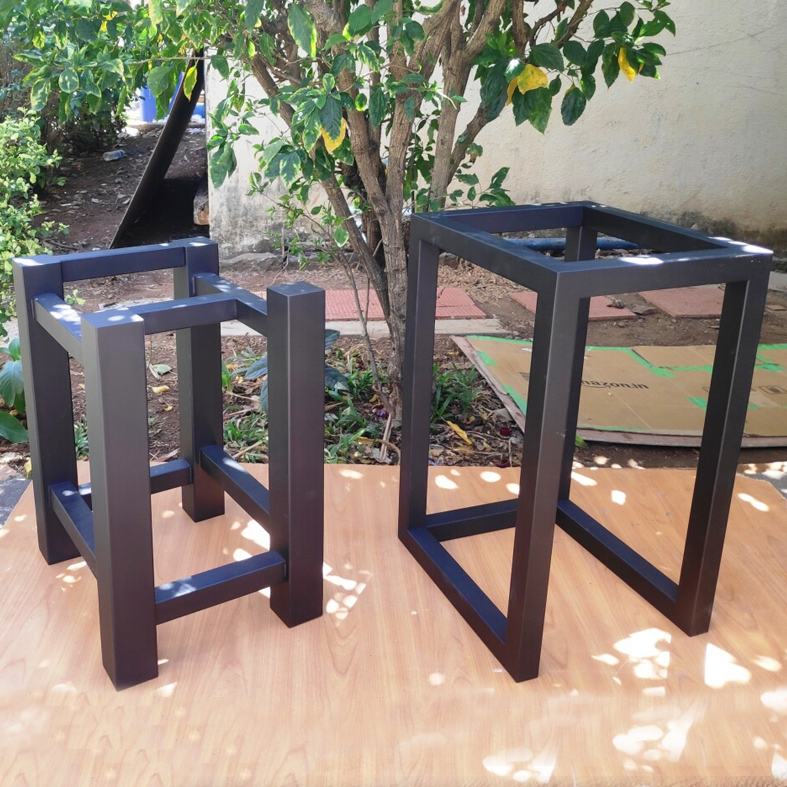

This is a whole differnt concept - open framed stands - also called lossy stands
these are reccomnded by some manufacturers who have tuned their cabinets to actually vibrate and the want the stand to accentuate that
(that too with certain MODELS ONly - not all )
so originally these were metal stands
both harbeth and spendor had them ( for certain models )
the wooden stands came on later to match the woods and since wood looked better
tonetrageur made them more famous
and as i said the signature that wood imparted coulds also be a contributing flactor
though as i said originally
Both harbeth and spendor started out with lossy metal frames
and thats still how we do it personally

@magma, glad you could join the discussion and share your extensive experience. I am using your stands with my Harbeths and they sound fine!:)
Some friends have suggested wood frame stands as recommended by Harbeth. I am mulling this over.
