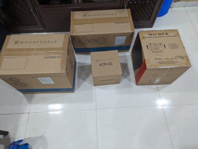

Boxes boxes 😜

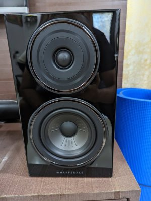

Wharfdale Diamond 12.1

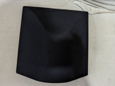

Wharfdale WH-DFS

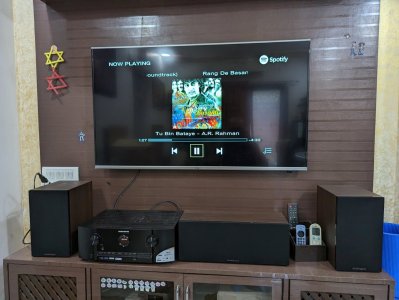

The front stage. I know it's cramped, center is off-center, but this is the best what I can do at the moment.
This is a start, more to follow 😀😀

Hi Suku,
Congratulations! Your setup looks very nice and the speakers look beautiful. I guess the center speaker position could change a little bit but can understand the shortage of space in Mumbai.
After your subwoofer comes in, it will sound even better especially for movies :)
I know!! Unfortunately, the AVR won't fit in the cabinet, it wasn't designed for an AVR. I'll check again though. Should be fixed when I move to the new place.

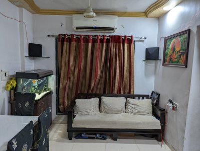

Just got around to install the surrounds. Upgraded from 3.0 to 5.0 now, and completed Audessey callibration. 😍
This is where I'll stop for now.

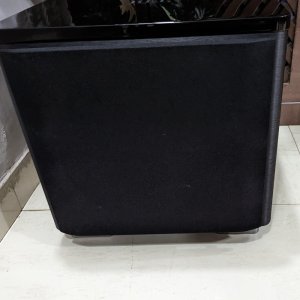

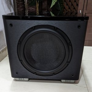

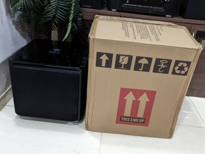

So, the little sub is here in a huge box 😍
Some more images:

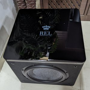

The top surface is very reflective.

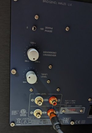

Hooked it up, and set it up manually for now. Changing speaker configuration, resets Audyssey and disabled dynamic EQ, volume, etc.
Settings in AVR:
- All speakers to small
- Speaker crossovers at 80Hz for LR and surrounds, 90Hz for center.
- Subwoofer level 0
- LPF for LFE at 120Hz
Settings on Sub:
- Crossover at Max
- Level at 12 o'clock
I then played some of my known tracks on Spotify connect, and dialed the level down till I liked it. At around 10 o'clock, the bass seems perfect.
Everything seems fine. Even when I am standing next to the speakers and sub, it seems like the bass is coming from the speakers.
Now on to Audyssey at night 😀😀

Looks nice.....consider placing the sub on a door mat so it wont vibrate
