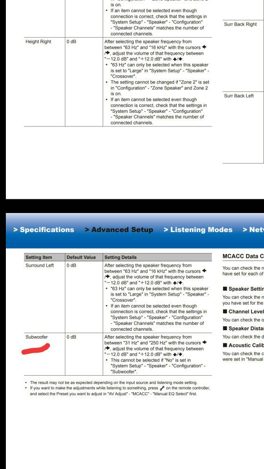

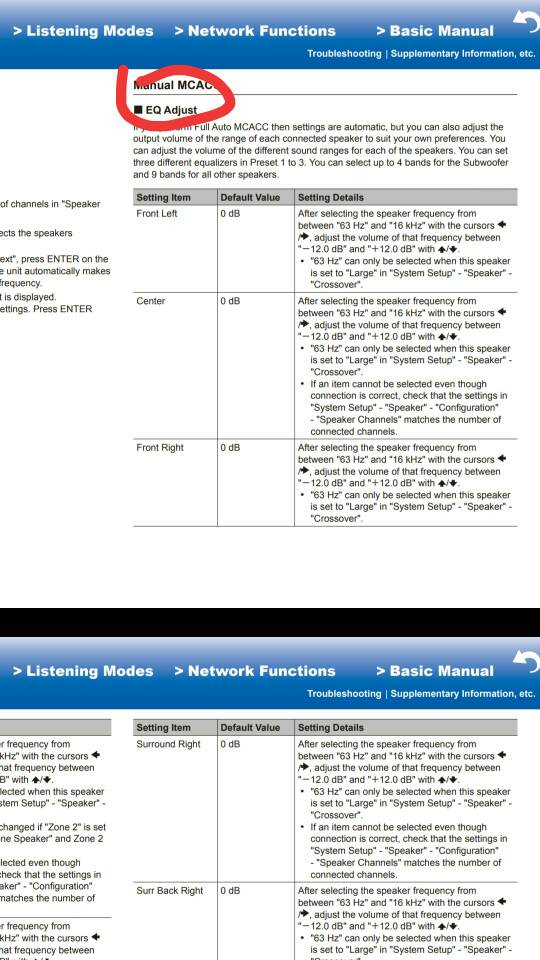

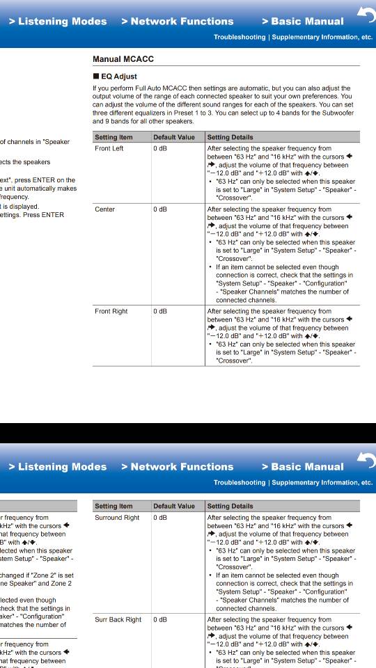

Did you checked manual speaker setting for equalizer option for sub and for all other speakers.It is available in Lx 59 model.?
Sent from my CPH1609 using Tapatalk

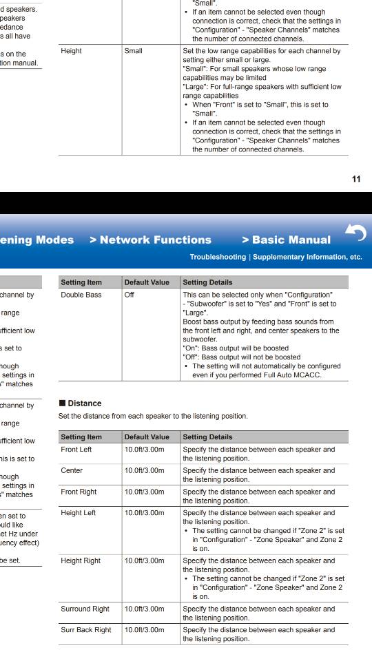

You can try this double bass function.
Try below screen shot aswell .
M sure if u try those your problem should be fixed
