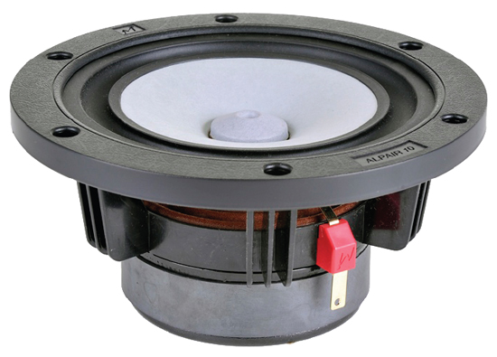

They look like Mark Audio. Have they changed their name!

Please do explore the mark audio drivers and their potential. The Pearl audio Sibelius is very well respected and accepted in the musician / audiophile community as a very musically satisfying loudspeaker. The designer worked closely with Mark audio to develop that speaker.
Yeah, I have made Frugal horns for a friend using Alpair 7A. I still have a pair lying spare, which I promised to sell to Romit, who tuned my Statement speakers.

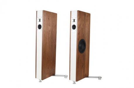

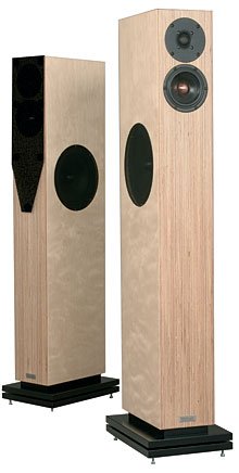

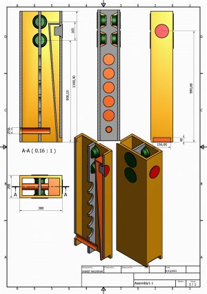

Once the drivers arrive, I will work on my version of Poison 8 / Pen Audio / KEF Blade.
I suspect I may need a small tweeter above 10k, so I have considered an option for using the Fountek Neo 1.0CD. I am considering using a Mini DSP 4x2HD for crossover and time alignment functions. The cabinet might include constrained layer damping and baffle isolation, and for the plinth, I am considering copying the plinth of the Q Acoustics 500 (see below)
