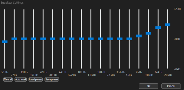

Yes, I am using Foobar, have adjusted hight frequencies, treble has become higher, somewhat to my liking. works for some some files, but sounds too shrill for other. Will keep fine tuning it.

IMHO, I don't think using another player will solve this issue. The only way to eliminate what is causing your problem is to get a good source material. Spotify is an easy option. A good system will be brutal. It will make bad recording sound bad.

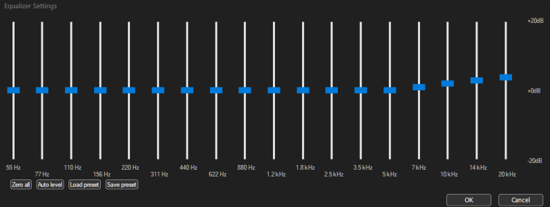

Have adjusted foobar 2000 graphics equalizer'd 10,14,20 khz to increase treble levels as per my liking.
Disclaimer - All of these observations are of mine as a Noob who has got a hi-fi product for first time. In past has only used/ listened to Tape deck (cassettes), Sony HTiBs, various 2.1/5.1 Pc speakers only. So please take my observations as a novice's rants who has no experience or no idea what hi-fi is and how to make them sound good.
