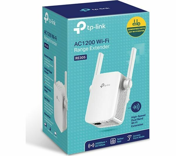

if it is just a problem in one bedroom; rather than get a new router, I would suggest you get a wireless extender with a wired backbone. i.e a cable from the router to the extender and then the extender. ideally dont get one with a wireless backbone; because they tend to consume a lot of bandwidth.
this is one that a use for the one troublesome bedroom of my house. much cheaper than a quality router. ( I don't know this store but this is the only one I could find when I googled -amazon has removed all electronics from its storefront). you will need a cable though.
A distributed setup using low cost components and a wired backbone will best a fancy router anyday in a typical apartment.
